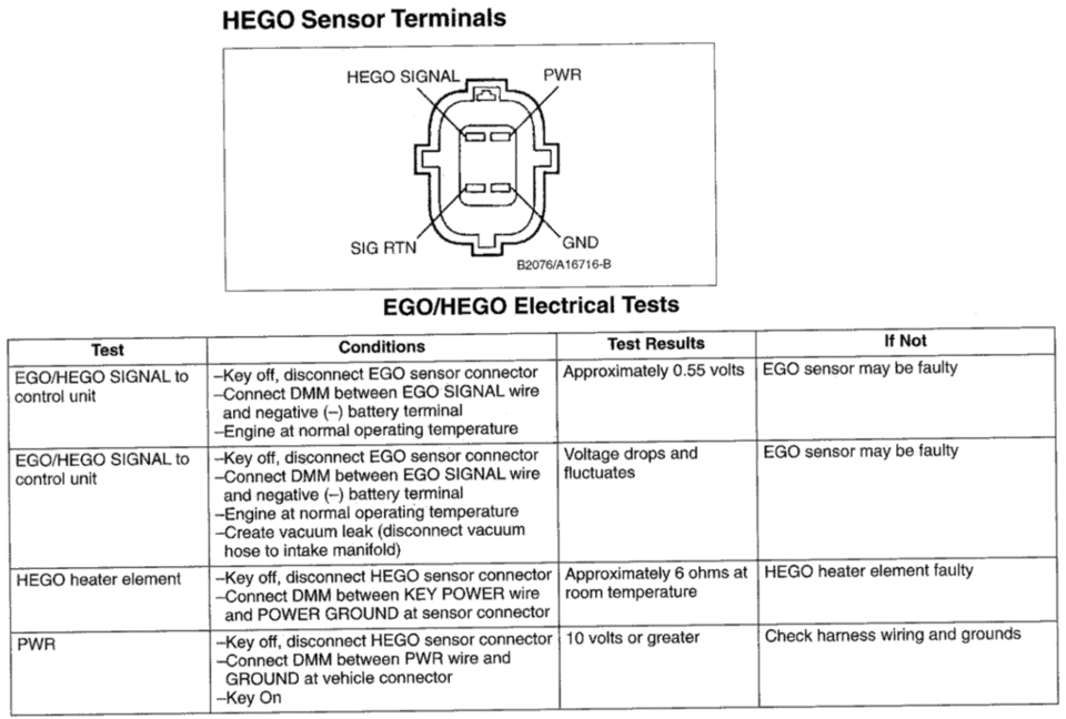

Heres a 02 test if you need it.
I believe the only thing its missing is testing the 02 signal wires from the 02s to the ECM 60 pin. Pay no attention to the Signal Return test, its not used on 3 wire setups.
