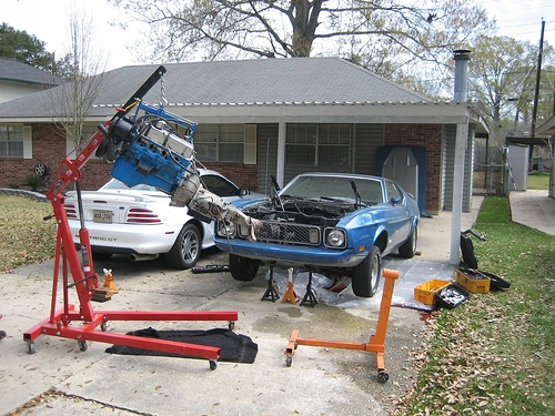

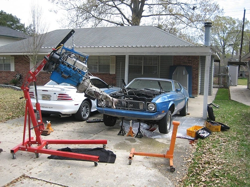

Hey man working under the carport w/ the car in the air is half the fun. :) Having a car lift is for weenies. The pic above is what I did a couple weekends ago... :rlaugh:
