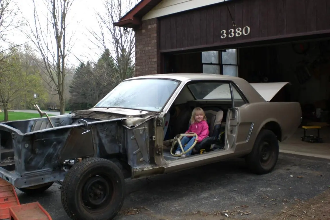

This pic is a couple years old (I"m slow with this project) but the cars seems in pretty good shape. mustang.webp
