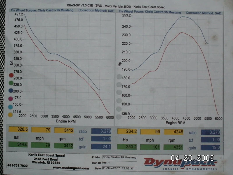

It made 265hp and 497tq but since then I've upgraded the fuel system and the intake....I have n't taken it back. But there wasn't much of a power increase. Ed Curtis and The comp cams calculator both estimate around 550hp....Only thing is Ed wont give me cam numbers and the numbers from Comp Cams are close to those of the cam i have now.

OK Guys...i found it...heres my Dyno Sheet. Tell me what you think??? Theres no excuse for this kind of dyno. The heads suck. Cam isn't the best but should make more than what it is. Like i said...Its the Pro Comp Heads.
