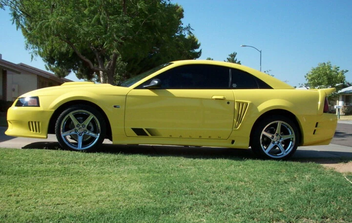

ProKiller said:
what about c pillars?
decal kit.
351W, vortech S-trim, racecraft suspension...
they have a black rounded area to match the flow of the window shape. ive seen then for 94-98 on their site but cant find pics on a car. did the 94/95 have the 200mph speedo?
