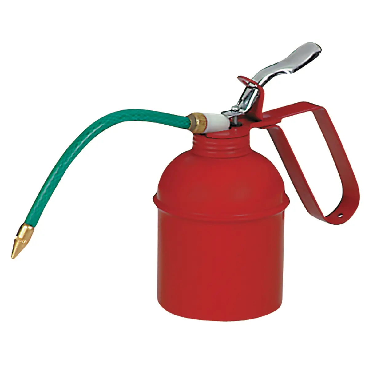

A couple of squirts of oil from a flexible spout oil can will not hydrolock it. A couple of table spoons would be too much ant would still not hydrolock the engine.

i picked up a can like that, but its a bit difficult getting it down to the plug holes. i may go get some extra tubing.
