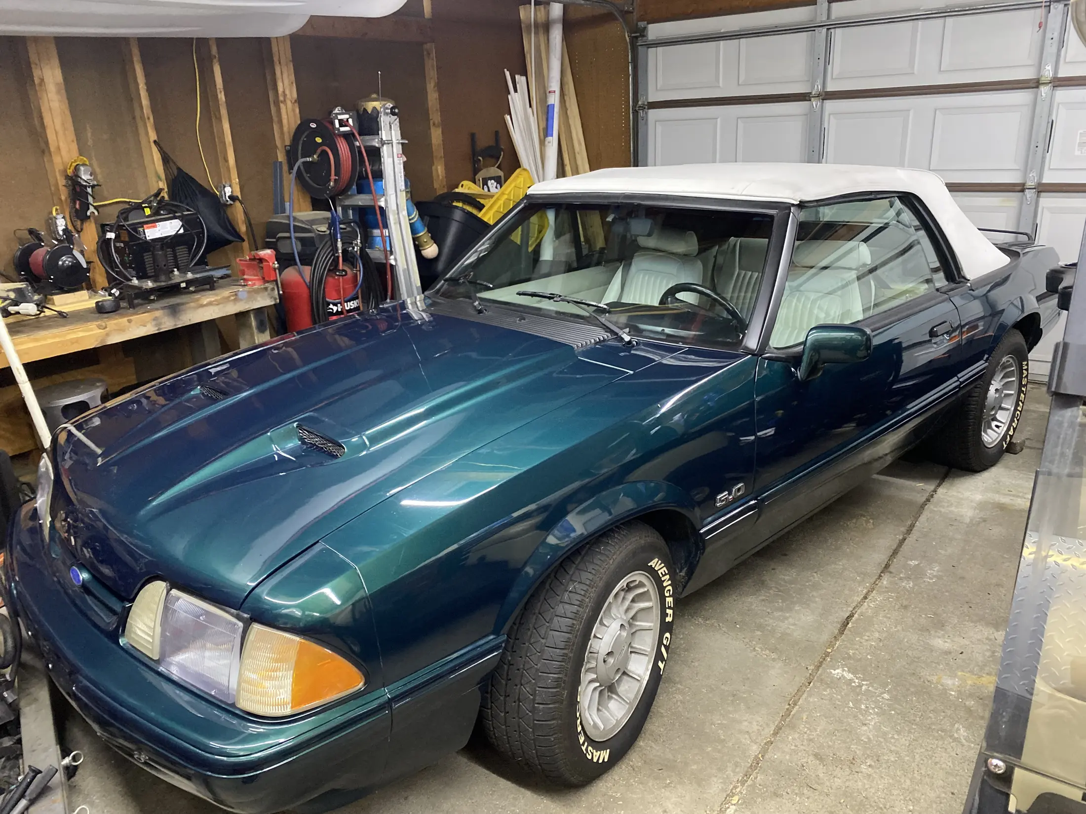

Picked up my first Mustang - 1990 5.0 with a 5 speed a few months ago. It appears to be a 7up edition but have not verified this. So I've only drove it about 45 minutes home after the initial purchase and then around the block a couple times. After parking it I found a decent amount of oil leaking onto the ground, and most of the engine, trans, underbody seems to be saturated. With winter now set in here in Michigan I figured this is the time to tear into it.

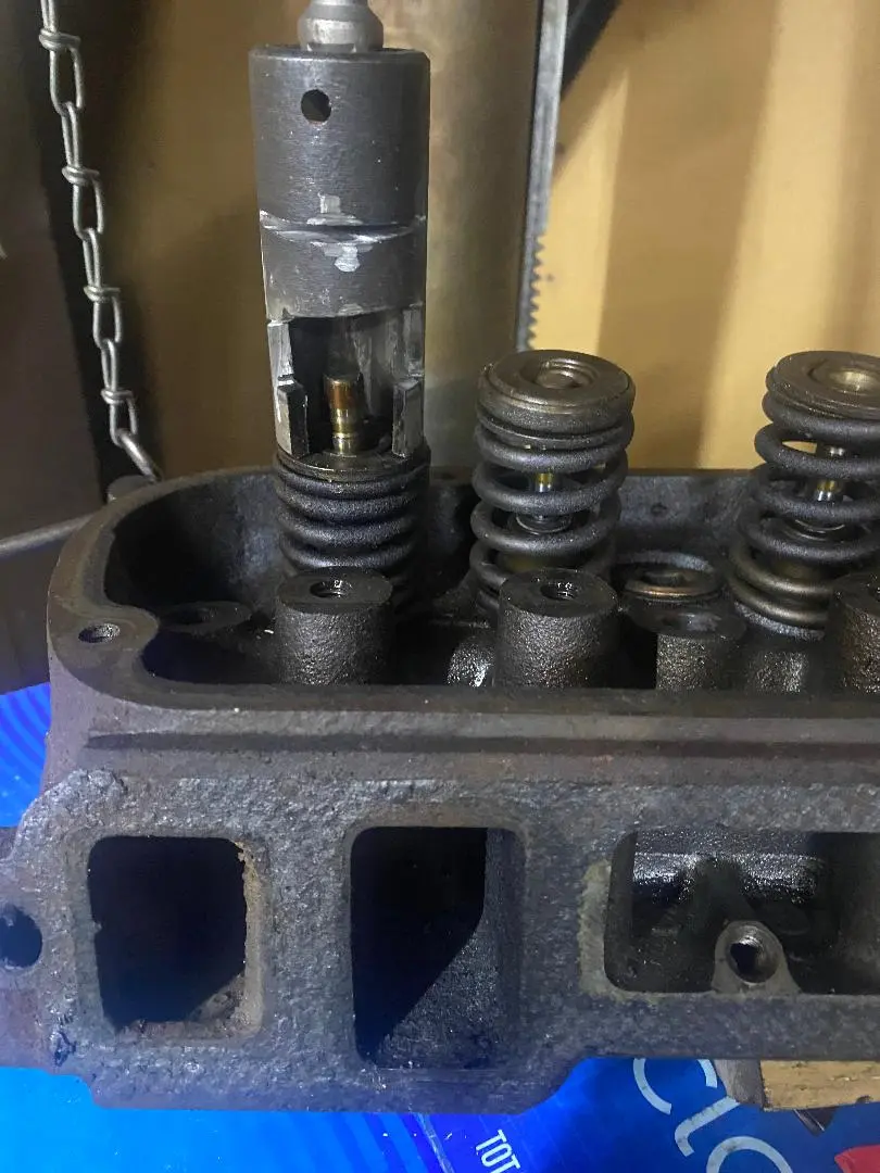

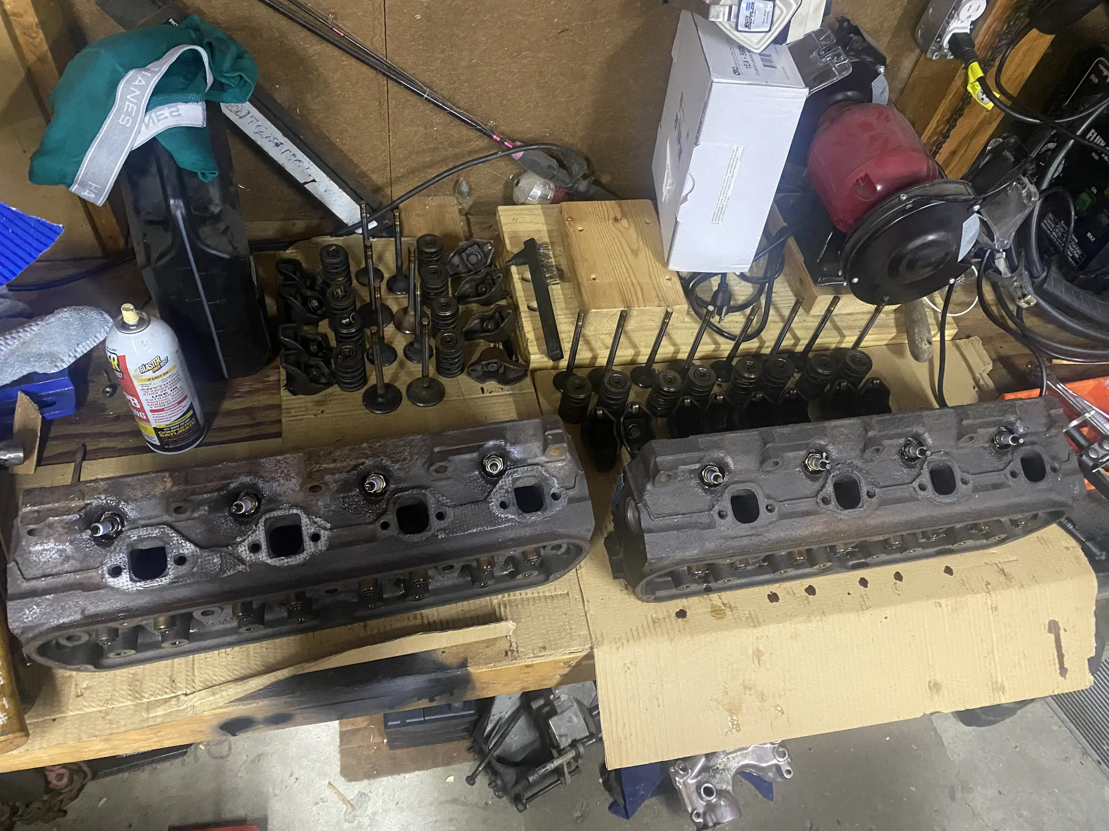

So today I disassembled the GT40P heads. Need to extract the broken intake bolt I found. But other than that, the disassembly went well. I tried cutting a deep well socket and using my drill press to remove the valve springs. Definitely paid off. I do have the hand crank spring compressor tool and after doing 1 spring by hand I'll go witht eh socket/drill press method from here on out!
I'll attach some photos of the car/engine/heads. I did a dry and wet compression test and then a leak down at 100psi. I'll attach those notes as well. Figure the results weren't horrible and the car was running fine, but any opinions on the results or anything else is this build are welcomed! Would hate to miss some simple stuff while I'm this far in.

Looks like a really clean car. Are you going to change all the gaskets on the engine while it's out. I'd do a rear main seal, a nice one piece oil pan gasket, front seal, etc.

Man what a nice car,the interior is in great shape,body is straight and the paint looks good too, for what i assume (by your location) is a northern car it must have been garaged most of its life cause it still has its body,lol, what a fantastic winter project.
I used to have one of those hoods on my 91 but mine didn't have the grilled inserts, not sure why i got rid of it but its been a couple of decades,
i wish you lots of fun with the car and the guys here are top notch when it comes to knowledge, they got you covered.

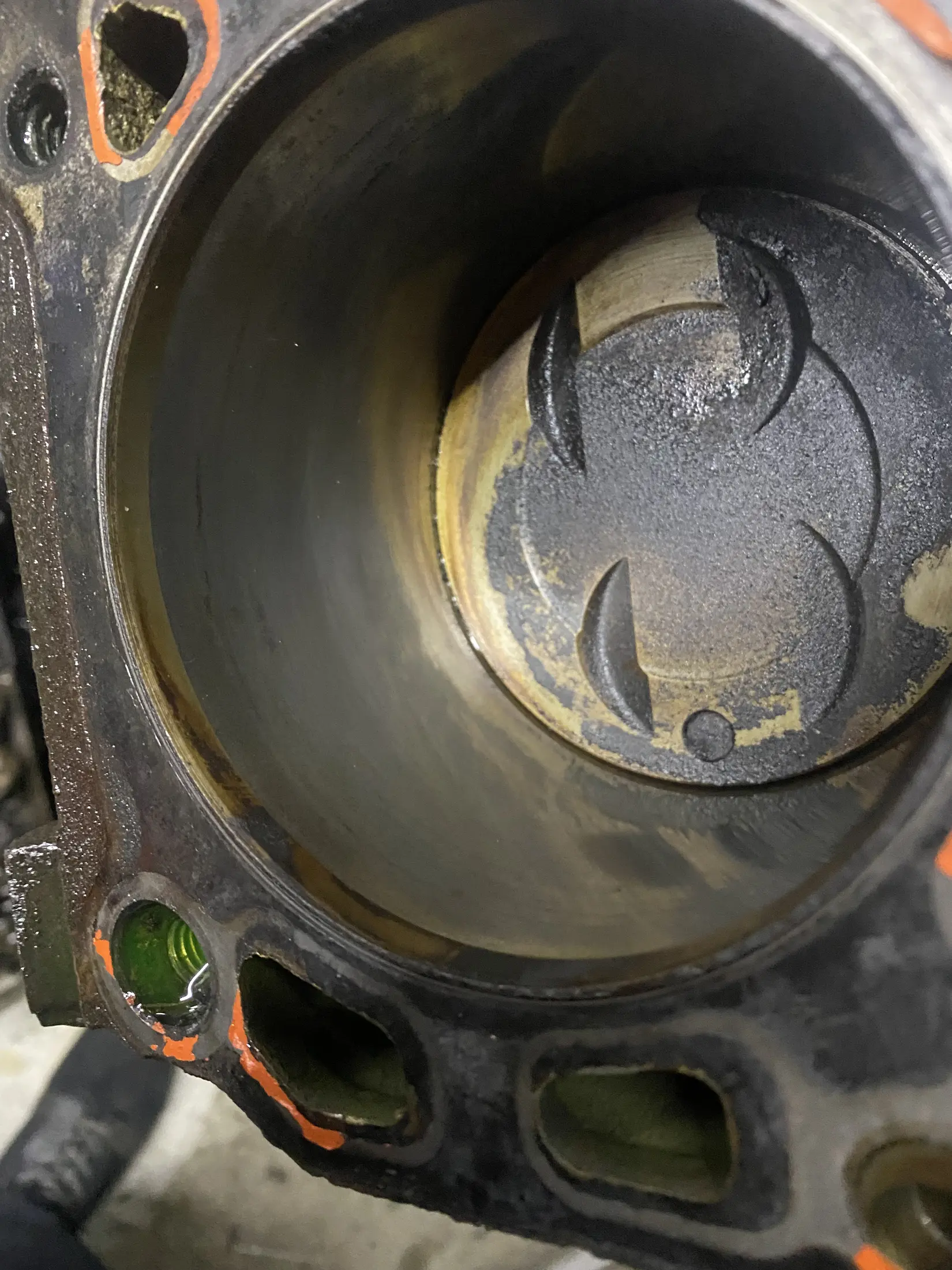

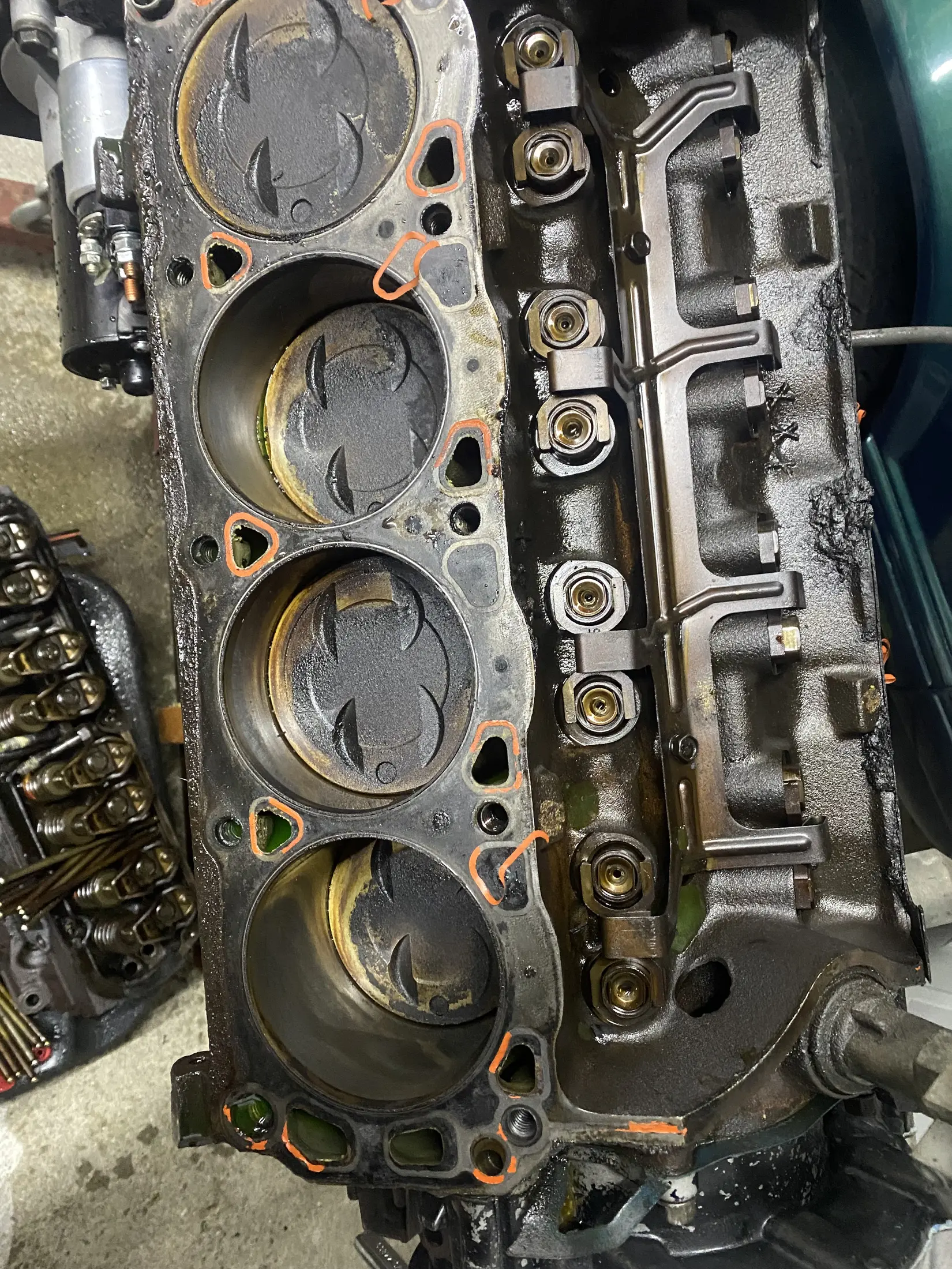

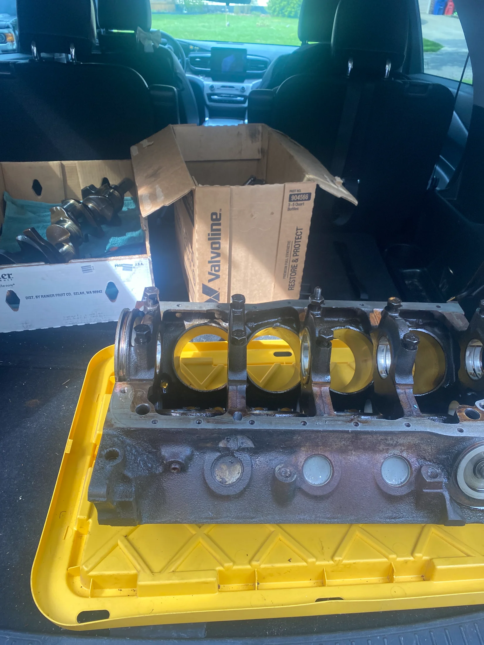

The block just went out to get honed, crank polished if needed, mic'd for bearings, degreased etc.. It all looked clean and probably recent rebuilt. Only thing that stood out was the amount of carbon and build up on the pistons.

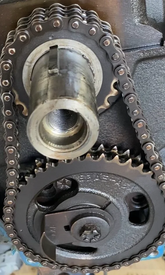

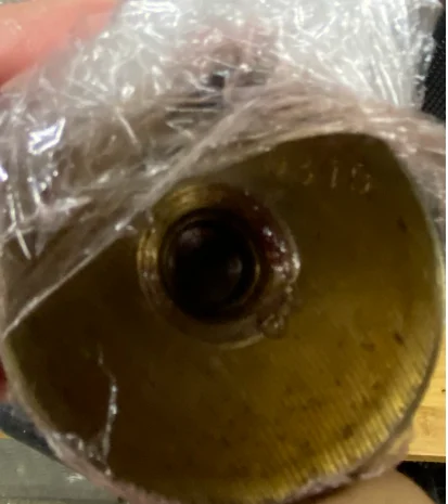

I found a double roller timing chain and cam stamped '0319'. Also #6 rod was missing and replaced with another #7 rod and cap.

How many miles? Those pistons ARE CLEAN IMO for a 36 year old. YES 36 years.

So its been rebuilt before, thats why those pistons look like they did.

Speedpro pistons are fine with regular ring package, but a more expensive piston with thinner rings means less friction AND less heat.
