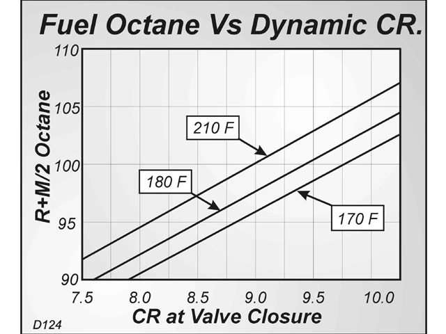

*This is an interesting graph from that link above. Vizard?
Copy that. I notice both conventions are being used: The Wallace calculator uses .050" timing but the Kelley DCR calculator uses advertised. Seems those that are using .050" figures add 15* to the intake closing point, but that doesn't always fit. My Steeda cam would need to add 30* (280-220)/2. Seems to be a case of caveat emptor.
