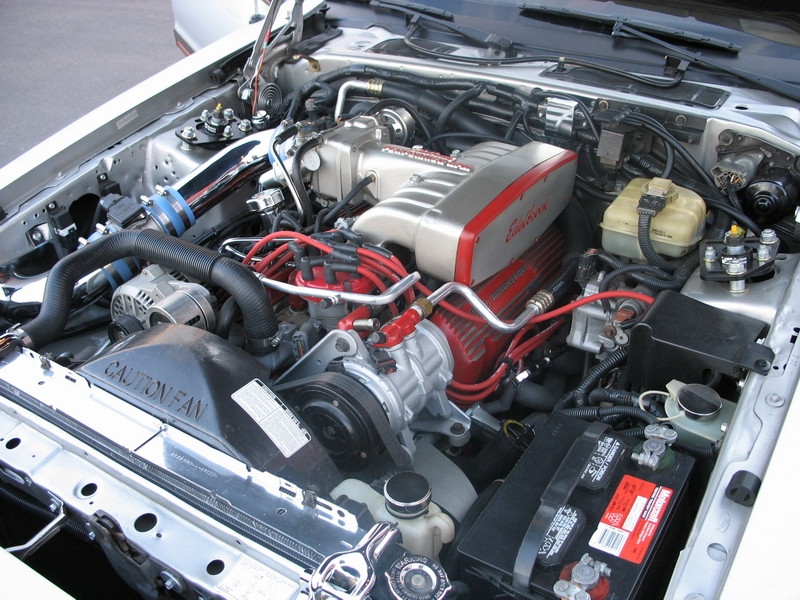

I did have the stock pistons notched.
See pic of engine installed.
Rick

Boost really depends on what your compression ratio is. Typically a 9:1 compression ratio should be good for 8-10lbs of boost. Some people run a higher compression but run the risk of detonation. A lot can depend on the tune that you get but higher the compression the smaller of a window you have to tune it to be reliable. FYI, if it is the stock shortblock the reliable limit before it splits is about 450-500hp. Again some get more but are either on borrowed time or have some lucky cast block. Very nice setup BTW.
Kevin
