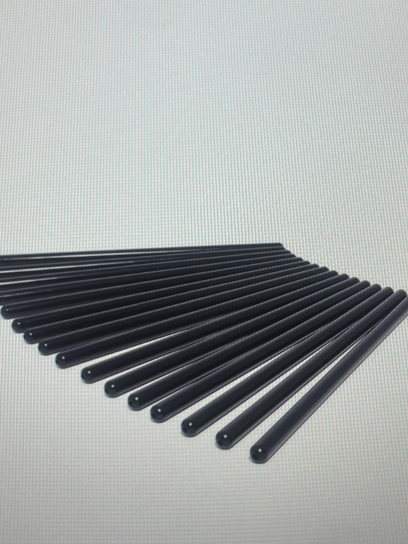

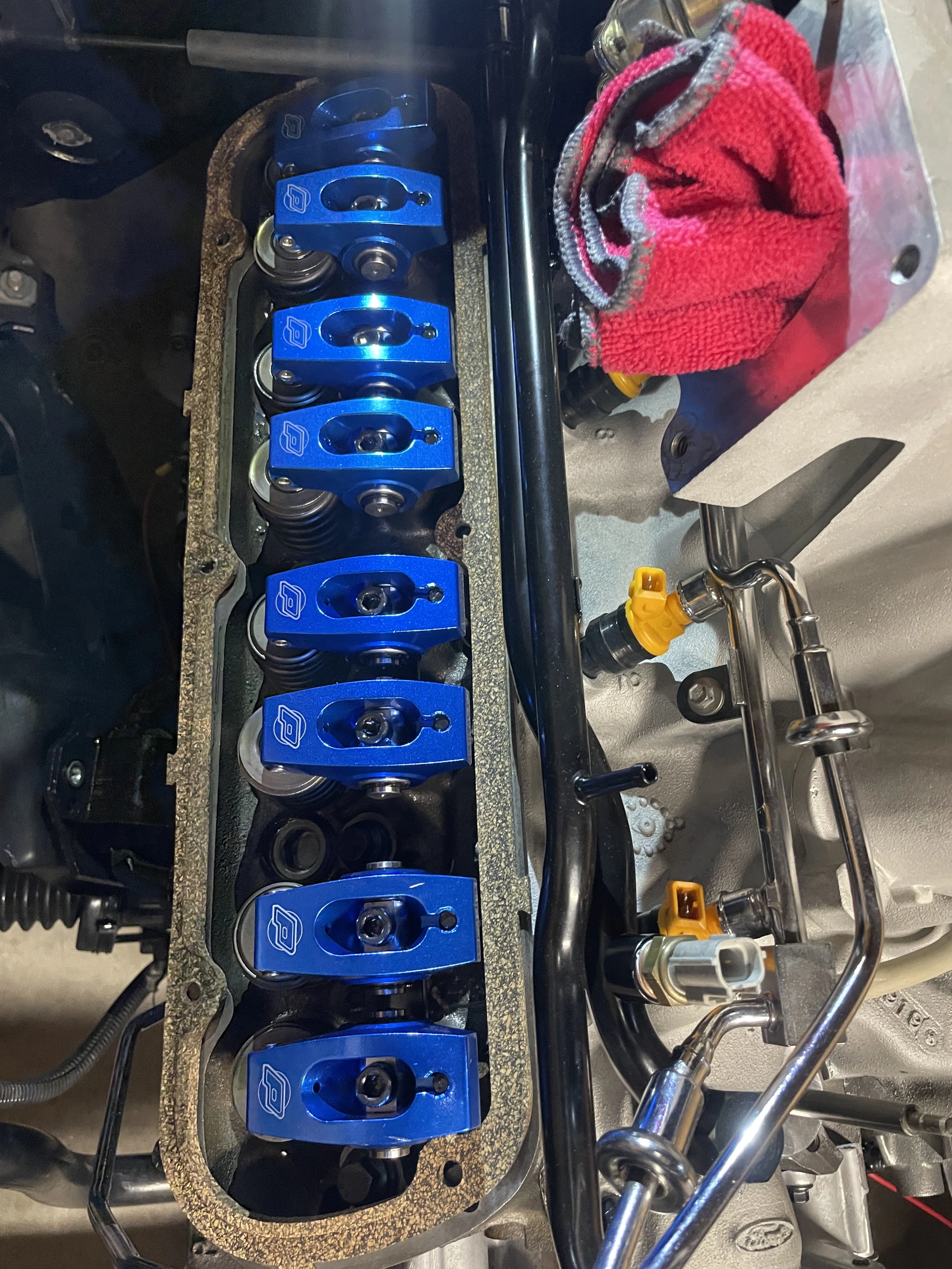

Sorry for the lack of information, I did use a pushrod length checker and the rockers I am running to determine the correct length. After adjusting the tool to 6.250" and checking every rocker by rotating the engine over a few times the sharpie mark was completely centered on all of the plungers after torquing them to spec, I did all of the rockers at the same time the same way as shown in multiple videos and I'd agree that the pushrods are too long or the rockers were too tight but number 5 cylinder has almost perfect compression. i dont have the starter hooked up yet so i dont know the actual numbers but the spark plug thumb test gave me accurate enough results to realize that 7 out of 8 of the pistons had 0 compression. I didnt use any shims on the rockers and the pushrods were a different style bought from summit racing but still stock length. played aroung with the rockers on number 1 cylinder and could not adjust to produce any compression. My main question would be how is it possible one piston is perfect when i did every one the same exact way?? Thanks for all the quick responses, will keep everyone updated
I think posting some pics of the work you’ve done will give us a better idea of the situation. Also, you think the pushrods are different than the stick ones? Explain that better and pics of both would help. I’m wondering if the end of the purchased pushrods is actually increasing the length of it. You could try swapping cyl 5 pushrods with cyl 1 to see if the issue moves with the parts. Good luck.
I'm away on vacation right now but I will try loosening the rockers and rechecking compression as well as uploading pictures, the difference in pushrods is the stock ones have the ball part almost tacked onto the rod itself whereas the summit racing ones are billet one piece that tapper up to round, unfortunately I sold the factory pushrods along with the stock block so I won't be able to post a comparison but they are 100% the same length as factory. I have been researching and it's possible the geometry is barely off by having the heads resurfaced and using an aftermarket head gasket, but I'll try the easiest options and hope for the best before trying shims and whatnot, thank you all for the help, it is greatly appreciated!
