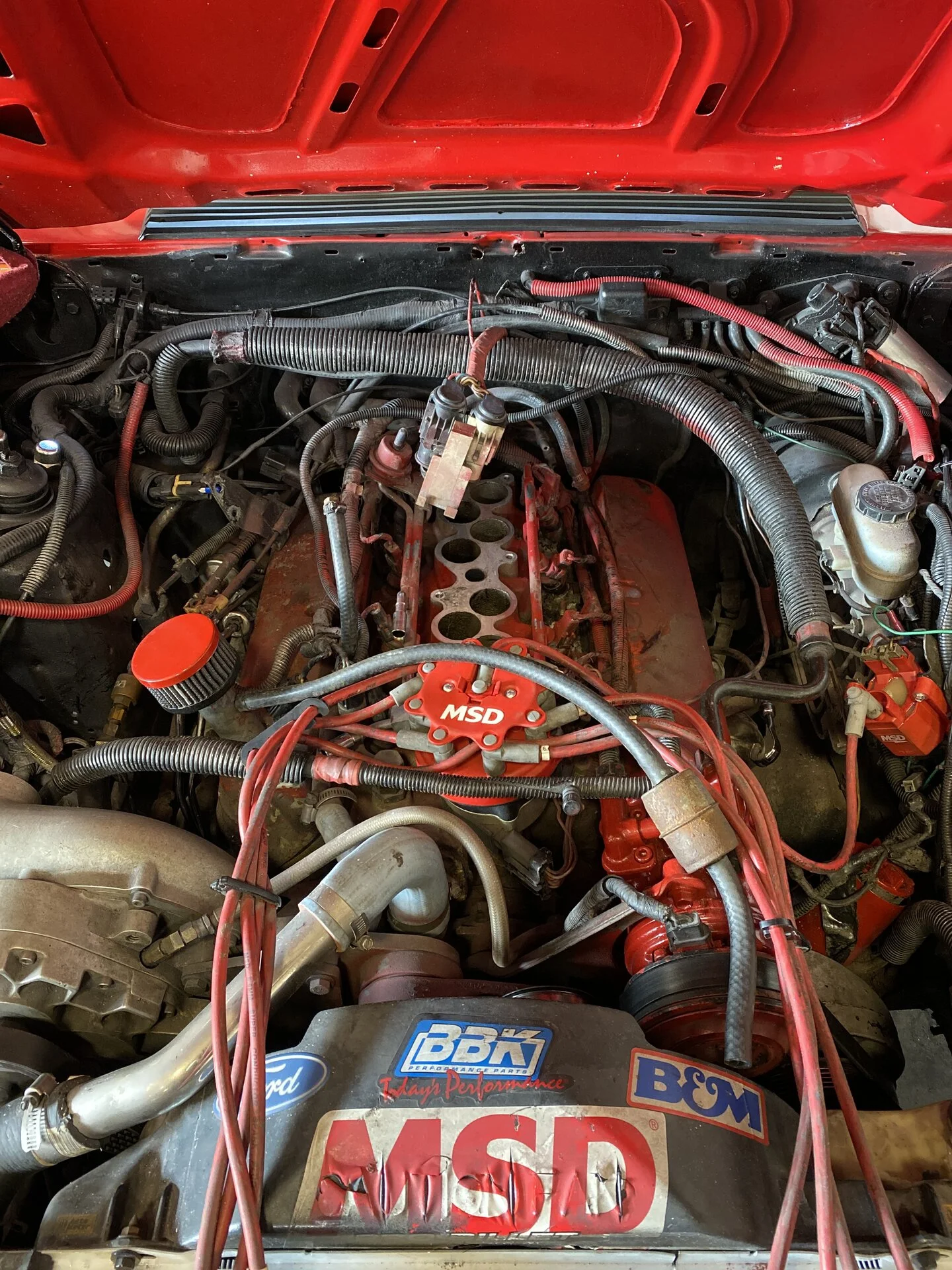

Well. Here is an update. My SC looks like it’s needs a lot of love. Do this look like stock lower intake?
Like the General said, it is an explorer or Cobra/GT40 lower. The Cobra, GT40 and explorer all are very similar. Same bolt pattern and you can bolt any upper (Cobra, explorer/gt40) to any lower (Cobra, explorer/gt40). Mix and match wouldn't matter.
