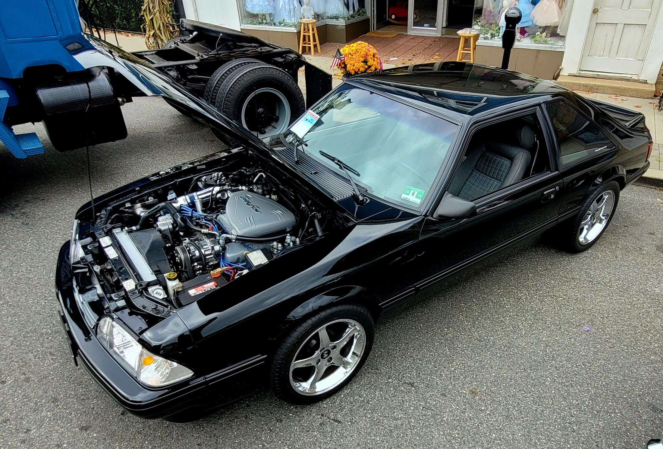

I did the Trickflow top end kit over seven years ago, runs just fine with stock ecu. I'm sure you could piece together stuff and save some money, maybe even more hp ? But I just wanted it all in a kit with no surprises. 76mm maf, 75mm Accufab TB, 24lb injectors, lifters, headers, fuel pump sold seperately.
