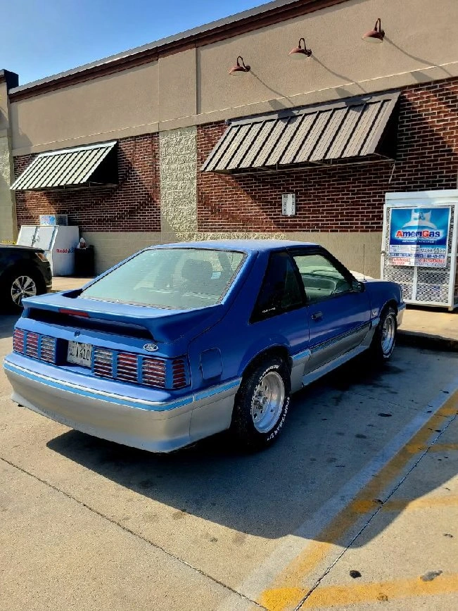

What kind of shape is the car in? How many miles? Pictures? Is this going to be a street car? Cruise? DD?
cars in good shape. Odometer shows 60k. Not sure if that’s actual or not. Guy before me had it about 5 yrs and was going to make a rd course car out of it and lost interest. He put the new interior in it. Still has stock gears but a set of 373 came with it. I’m just looking to make it a little street car. Nothing crazy. Not planning on doing anything with the bottom end at the moment
