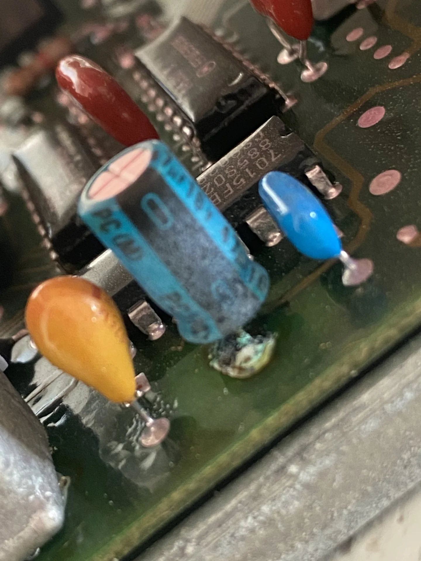

So after all these problems I have had. All the money I have spent. I decided to pull computer out. Please tell me this is the problem. The first picture looks like corrosion. But idk what a bad one looks like. Is this bad?

That computer is bad. ECUexchange to the rescue again. They are making a bunch of money from us. I've got a few I want to send to them.
That is bad.
The fluid inside the capacitor is corrosive, so when it leaks out, it starts to corrode at the solder joint. That's why often times folks will open up the computer and find that not only are the solder joints corroded, but they are also broken with the cap hanging in the breeze on one leg.
If you see any of that green corrosion on the joint, replace the cap.
That is bad.

After fixing the issues my vehicle ran a ton better but after putting 5 straight hours on it it started losing its rpm signal and rpm's got squirelly....Opened up the ECU and found bad capacitors....
Good thing I keep a backup ECU around because after swapping my F4V3 chip into the spare the truck fired right up and is running better than awesome now,,,,lol
