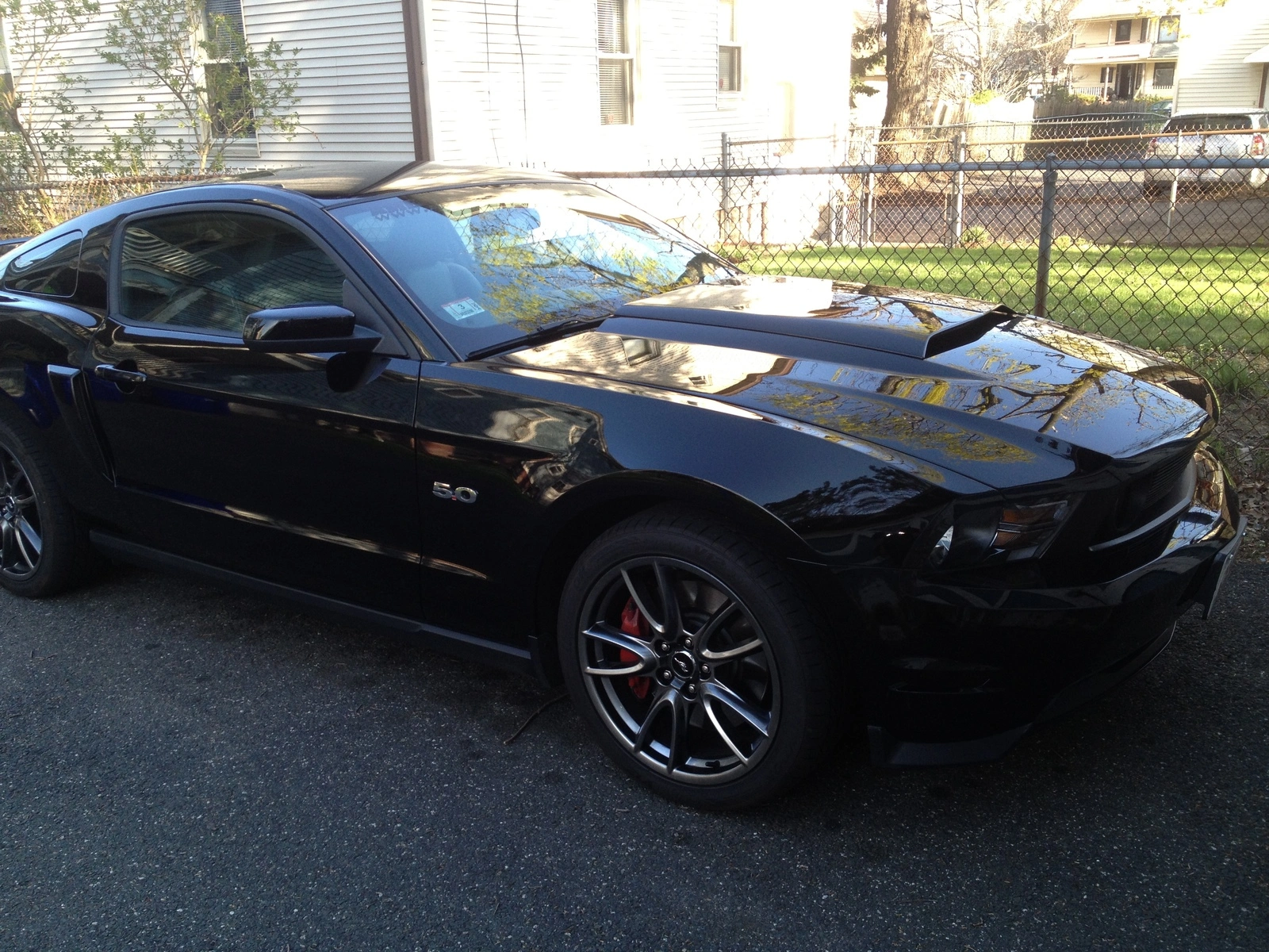

so i bought a 2011 gt black on black , awesome car , but i have an issue the print out of the car says it has Brambo breaks on it , they are red but don't have the logo on the calipers , is there any other way to tell if they are real

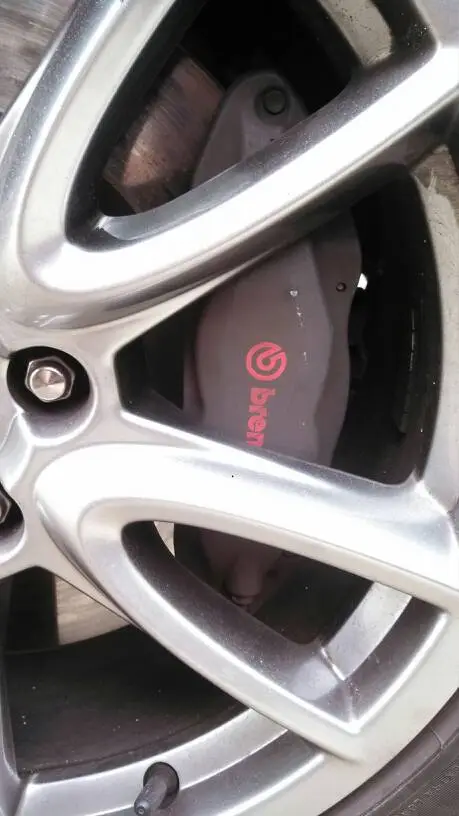

Any more info. What size wheels, the rotors should be 14", the brembos from the factory are goldish color, with the Brembo name and symbol on them. I'm pretty sure the name and symbol is cast that way, but I can check in the morning :)

my rims are 19 inch , tire size is 255/40R19 , i dont have the original invoice , i have a print out from the dealer an the print out with the vin says brembo brake package . but what got me was the logo was not on the calipers
So, I looked at your picture, and looked at my brakes. They look the same just yours are painted red. The Brembo is a decal, which would be easy to remove. The only other thing would be to see if it's got four pistons in the caliper. The base brakes are a twin piston design, the Brembo brakes have for pistons per caliper.
