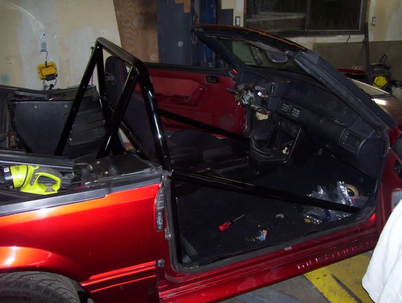

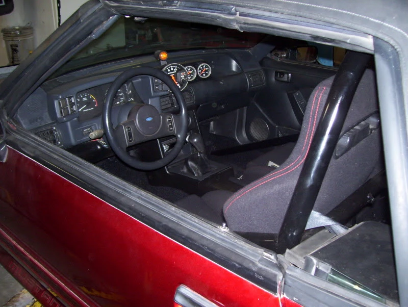

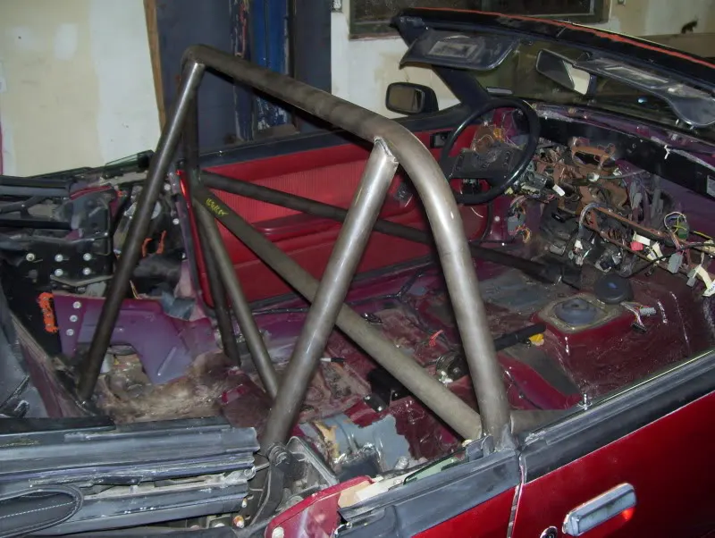

For my convertible i got an 8 pt weld in cage from S&W race cars. Mine is chrome-moly ($400) but the mild steel version can be had for as little as $180 and the quality and fit are very good. The ends that meet are pre-notched so all that you need to do is cut the bottoms to form to the floor, bend the floor plates, and weld er in. Its some extra work removing a lot of the interior to weld in the bars but I think it is worth it (I had all my interior out to swap to a black interior anyway so it was no big deal for me). Some of those bolt in bars are for style only and provide no roll protection at all. But if all you're trying to do is get it by mom, then :nice:
