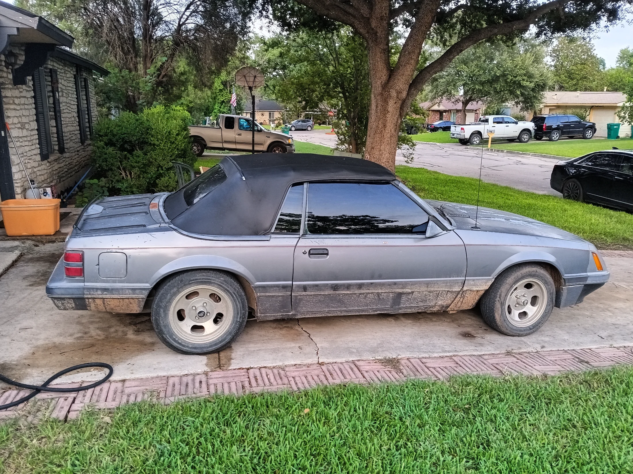

Long post, sorry bout that. Short history on car, bought it in Florida for moms birthday in 93, with 32k miles for $2200
Took it to Mom in Vegas, air conditioned garage. She put different wheels on it. I got it back 3 years ago, Texas has not been kind to 40 yr old paint. Still has original top, and interior is very nice shape, she sees lots of dirt road on the ranches, as you can see by the mud.
Anyway, she's all packed, her and I are leaving, for the Northern AZ ranch at
3:00 am , the 95 bronco, and 96 eddie 150, are waiting for us. Gotta love those 4.9's
Thanks Again. Very nice to find StangNet
