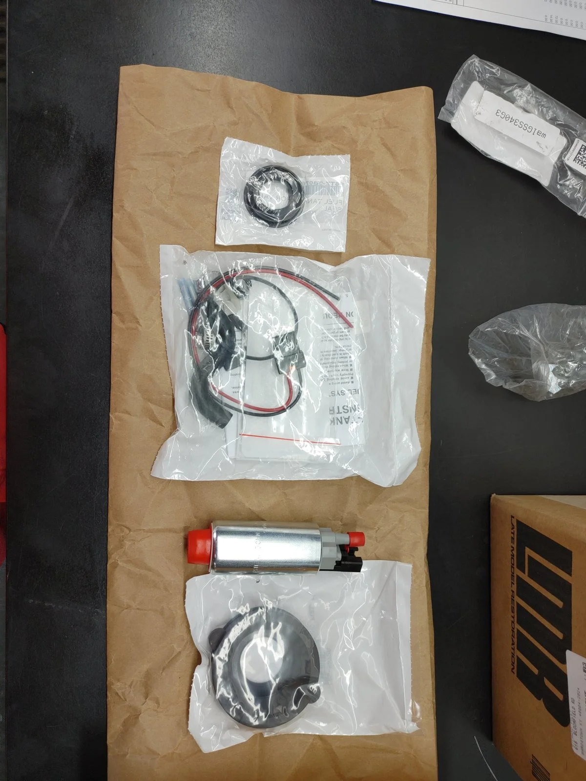

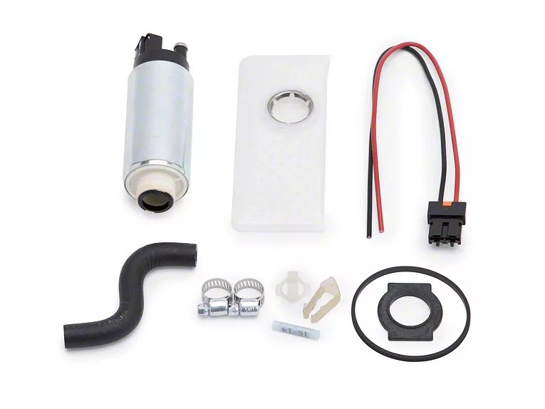

Yes I do use this board for a "Clipboard" at times. My rambling/thinking out loud actually pays off at times.
In looking over the specs, the sizes of the pumps, the tank differences, etc. I am believing that I need a 255 LPH pump which seems to be the one that is in the 02, but it is made differently where modifications maybe necessary to install it. I do not want to modify anything. I'm looking to compare some of 255LPH now
  1. Fuel Pump
  2. Fuel Pressure Regulator
  3. Float
