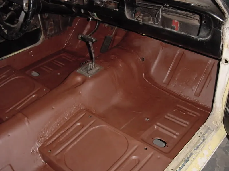

See if you can push a peice of stiff wire through the screw holes from underneath.
I think my original console had three screws on each side. One about 4 inches back from the shifter, next about 8" from there and a third about 12 more inches back. I'd post a pic, but I'm at work.

Dec 8, 2008
  • Dec 8, 2008
