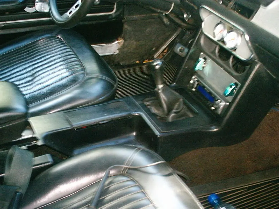

I took the "Po-boys" approach and modified a fox console for mine. Just had a couple laying around so I thought "what the hell". I have nothing but a can of interior paint in it, besides the switches. I still have some work to to on it though, towards the top where it meets the dash, but you get the ideal.

68stang351, that looks pretty good in there, once you fix the part under the radio at least (grin), are you using the emergency brake from the fox too?

My e-brake system needs some work anyway, so I'm thinking about using the fox handle too. (I have lots of parts and parts cars sitting around)
If I had the money to spend, I would buy one like Reen's, man that thing is nice. But I'm just to poor. Actually now that I think about it, someone gave me the switches I have in my console, and I had the paint left over from something else, so I really don't have anything in that console. I just have to make do with what I can scrounge up/afford. Looks pretty good for 0$ and maybe an hour of work huh?

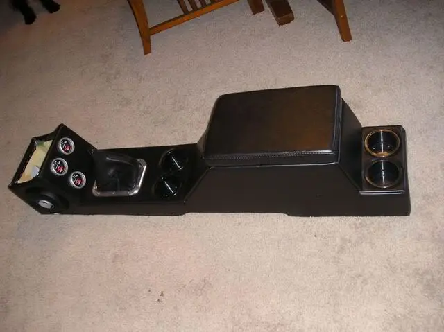

I made my own console. I now have 4 gauges in it. The fourth is a boost gauge.

I don't have any more pictures of the build process. I get so involved in trying to get things done while the kids are taking naps I forget that kind of thing. I made the console out of 11/32" plywood (over kill on thickness). I used 1*2" wood to construct a frame structure. I made the pattern by cutting a large cardboard box the shape I wanted. I think it was 43" long including the rear cup holders. It works great for me. The gauges are easy to read, the power window switches are easy to activate &, the cup holders are in the right spot. I am very pleased with the end results.
My car is at the body shop right now or I would snap some pictures of the underside frame/support structure. It looks rather crude from the underside but it is very functional. The best part is nobody will have one like it.
I had an upholstery shop match the fabric of my Procar Rally seats. IIRC he charged me about $250 to cover it. I am into the whole thing, less the gauges and window switches less than $300. The extra $300 I saved over the 68 shelby console I also looked at payed for all my gauges, switches, speakers and wiring for the stereo system.

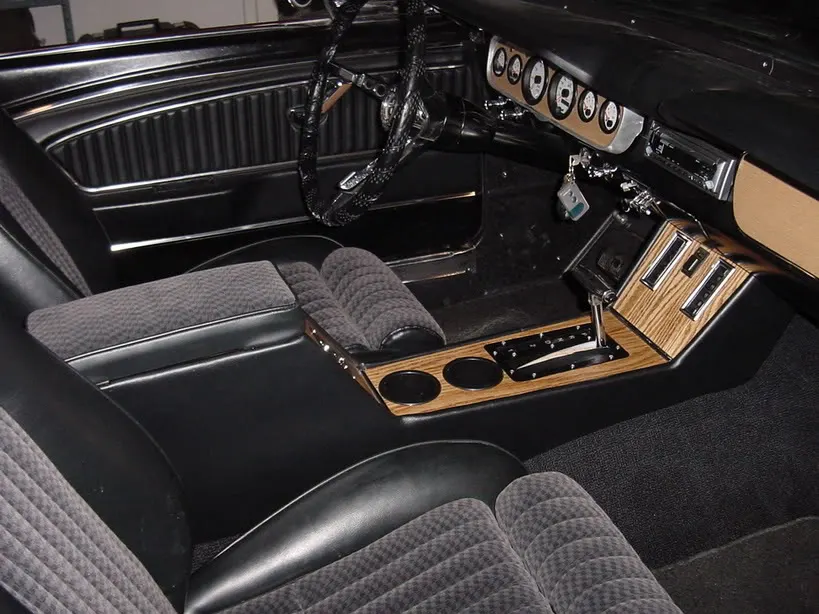

I made a custom console too:
buncha pics here:
http://s50.photobucket.com/albums/f315/Tim65GT/Console/

Dang, nice work you two! You guys have some skills with wood. How do they attach to the car, gravity? I also notice that Tim's has a more sculptured base, sort of like the factory consoles did, was that done with trial and error...fitting/grinding/sanding until it fit just right?
Frankly though with $300+ into materials (more for me with the stainless requirements) and labor and aggravation I'm inclined to pay ~2X that and know it will fit. Besides, with the brushed steel inserts my fabrication skills would be taxed beyond my ability.

Mine is a gravity fit. It is "wedged" between the area below the radio and the tunnel. The back fits snug between the Procar seats. That thing is not going anywhere. I have a plug that connects the wiring of the console to the car. Removal only takes a couple minutes.
As far as the difficulty, it wan't very bad. If I had to do it again I could build the frame structure in about 6 hours. Hand it over to an upholstery man and be done in a week. I will never start a business though. Even with a 100% profit it still isn't worth the headache of a business.
I have screws going through cross braces into the tunnel.
I used heavy cardboard as a template to get the scuptured custom fit.
