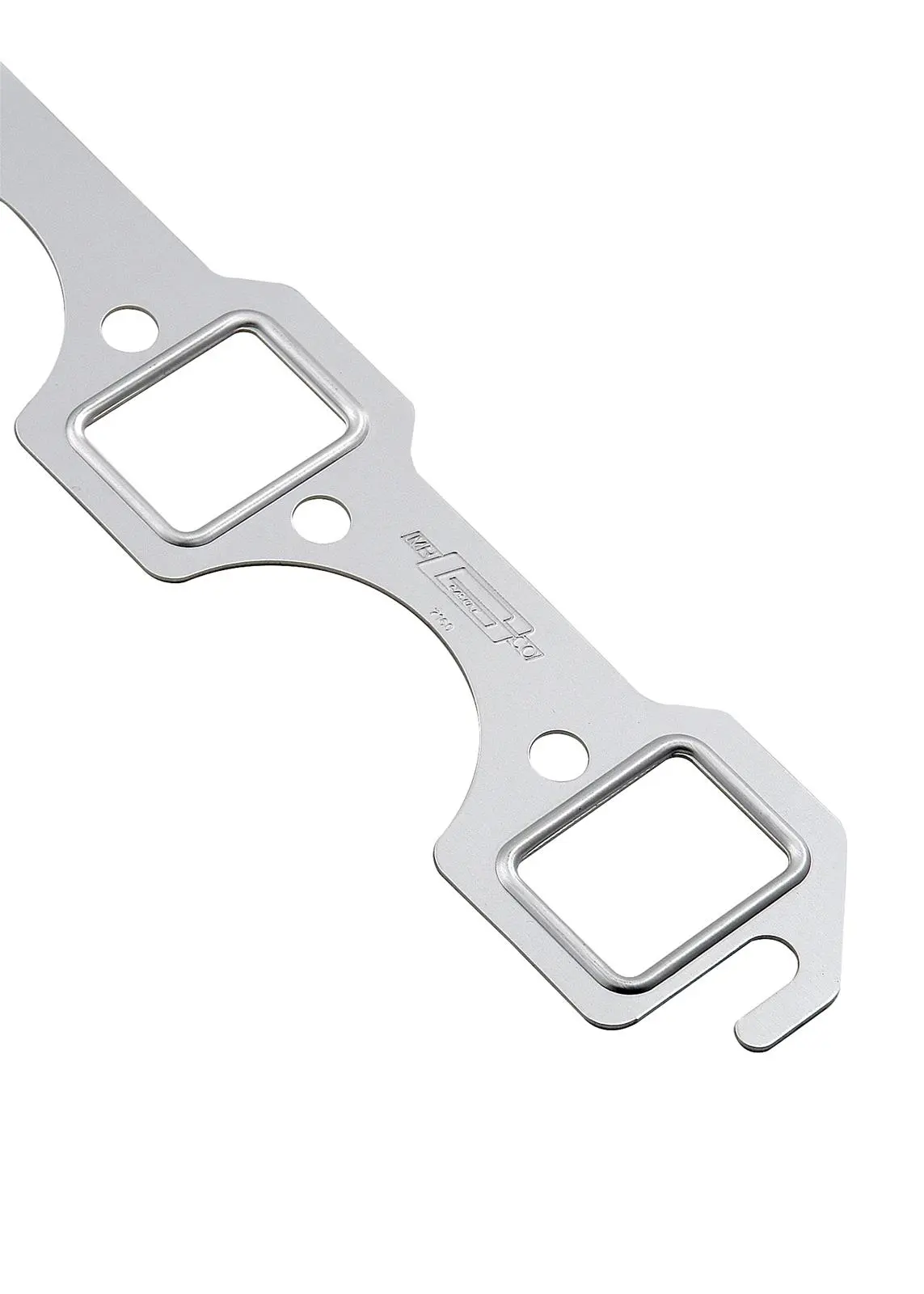

Exhaust manifold leaks make a similar sound to a noisy valve. If you didn't find a noisy valve, spend some $$ on a can of PB blaster and some new copper exhaust gaskets. Soak the exhaust bolts with the PB Blaster overnight.
Be sure to clean the gasket mating surfaces of all the old gasket material that may be stuck to them. Coat the bolt shanks, underside of the bolt heads and bolt threads with lots of Never Seez antiseize compound. You' be glad you did the next time you have to remove them; and yes there will be a next time...
Advance Auto Part # 80078
Look for gaskets with a slot for the bolts at the far ends of the gasket. That way you have 2 bolts still holding the exhaust manifold in place. That makes it a lot easier to install the gasket, it just drops in and sits on the end bolts..
See https://www.summitracing.com/search...d/engine-size/5-0l-302/gasket-material/copper
