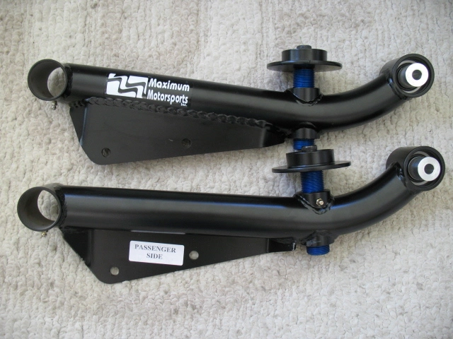

actually......
MM>ALL!!!
Just look how sexy my MM arms look.....

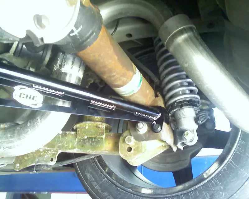

Adjustable lowers are only for adjusting height. Not worth $399 in my book.
These are the only type of lowers that work.

What kind of brace is that on your rear end oxford? I know I have heard of it, but have never seen one installed. Like it?

i believe that brace is to support the axle tubes

Gotcha. I vaguely remember that. Would that actually help? What kind car would need that? Drag or open track?
