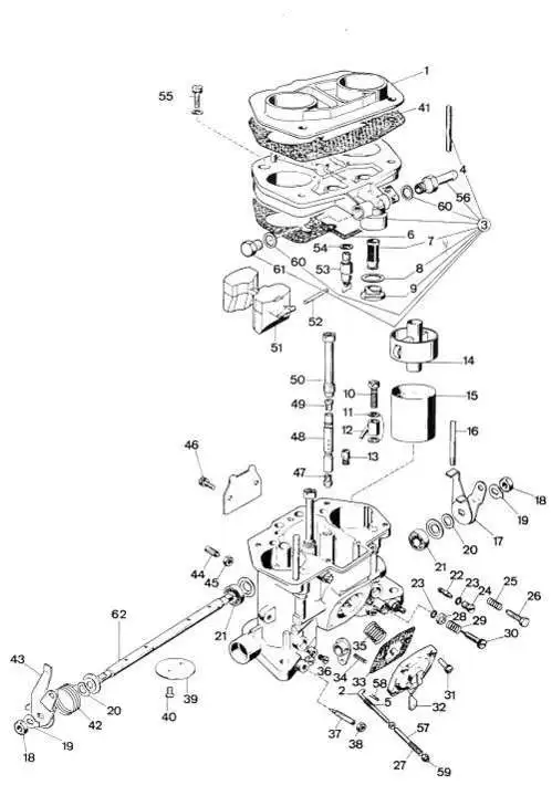

dragnazz5.0 said:
never heard of that carb and honestly ive never used a carb on one of my cars but i understand fully how they work. ive done some work on a 78 spitfire that has 4 SU motorcycle carbs on it...kinda trick at first but really easy to work with.
i understand that there is a wealth of knowledge out there for ford EFI but ive always liked carb cars and the simplicity involved. in my case im not so much doing it to get away from efi problems and searching through wiring diagrams to figure stuff out but im doing it for aesthetics and because its something that ive never done or had to deal with and it will definetly be a challenge.
Diagrams and pictures courtsey of http://www.carburetion.com
4 Webers and a manifold for your 5.0... A quick way to spend $3000...
Weber exploded diagram... more little parts than a fancy Swiss watch...
