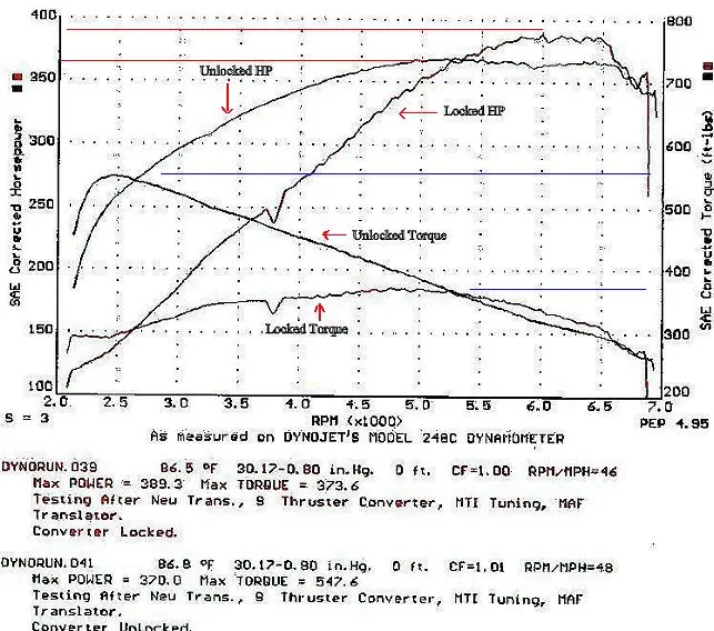

Here is a dyno graph of a car ran with a lock up, then a non lock up conveter tested the same day.
Below 5,400 rpms, the non lockup has much more torque, and more HP. The farther above this rpm, the lockup converter starts to have the advantage. Since the AOD uses lockup in 3rd and OD only, you would only see the differance in 3rd gear while racing.

makes sense. thanks for posting that graph too.........i definatly thing a lock up would be for me as my goal with this car is to get performance out of it be remain as streetable and simple as possible. 1st and 2nd is where it will really need the stall anyway. i see some get a 3000 lock up and they say it's loose but tolerable. i assume that means it's great when you stab it but 1st and 2nd are a little mushy when your just barely into it.........

According to that graph the lockup is better for top which makes sence because less power is being "slipped". I know a tq converter turns rotational energy, (power, kinetic energy) and turns it into torque (potentail energy). So it all makes sence, unlike my spelling.
