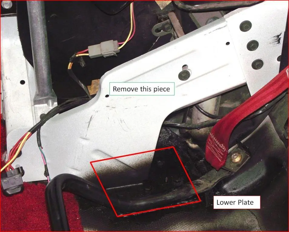

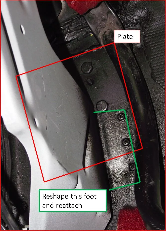

A couple things on the vert - when you get the quarter panel off and are going to drill the holes for the lower box reinforcements, you'll want to remove the metal brace that's attached to the floor. If I remember correctly it's got 3 or 4 rivets holding it to the floor pan. It bolts to the convertible structure at the upper end. The plate will go right under the lower 'foot' of this brace. I took mine out and reshaped the feet on my vice so they'd fit with the thicker floor. I used screws to reinstall them.

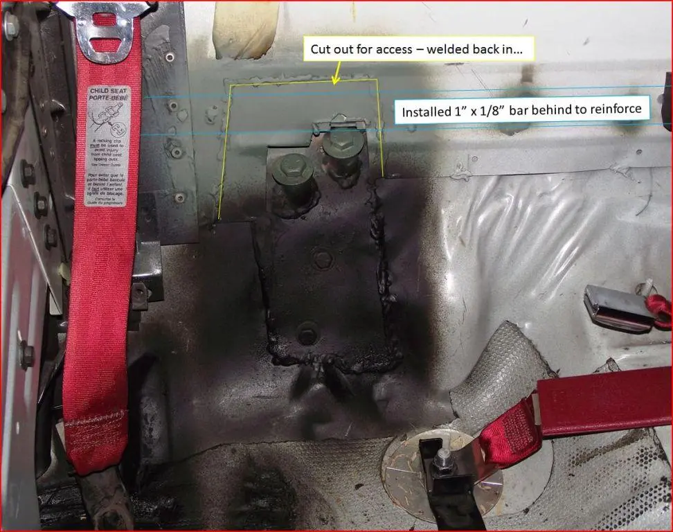

The other issue on the convertible is that when you do the upper ones, they say to put the bottom one in place and drill up through the floor. Well, the hole is going to be either just behind or right on the wall that closes out the back of the seat. You'll have to cut some of the wall out on both sides to install the top plate and bolts. I've heard that when I reinstall the seat back that I'll have to notch out the back of it to fit over the bolts.
This is just how I did it... not sure if it's the same story for all of us with convertibles or not. I can't see any way to get the upper plates in without cutting out some metal.
