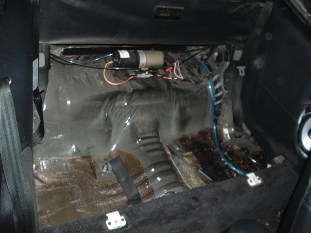

not the link you are looking for, but at least this shows the locations of the things you have to push to get the bottom part of the rear seat out. those are the white things in the pic below
iirc, to get the top part of the seat out, you have to take a couple of screws out after taking the bottom part out
after that, you can finally get to the quarterpanel that covers the motor you are after.
good luck ...
