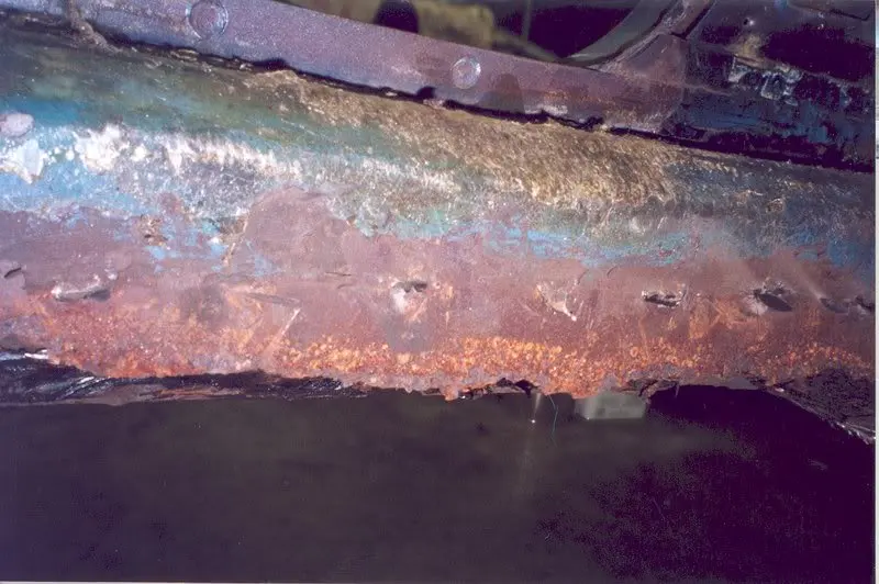

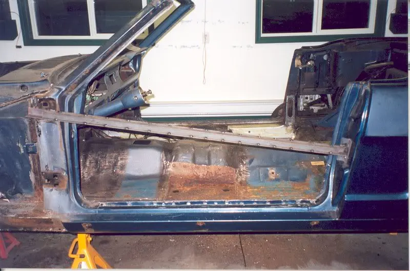

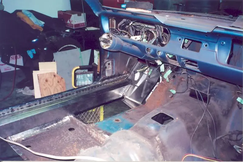

The key area is your inner rockers (and torque box), if they rot your car will start to fold, the top of your door will start to overlap the top of the quarter. Mine hadn't folded but I was running on borrowed time, as you can see what was supposed to be a complete box is down to an inverted "U"

Well I see that you're in Texas, that helps a lot, I'm in the Pacific Northwest rustbelt where mustangs truly are rustangs I've replaced both inner rockers, floors, torque boxes, bottom of quarters (someone replaced the quarters but didn't do it right), rear cowl, fender extensions, still have to do the bottom of the fenders and re-skin the doors
