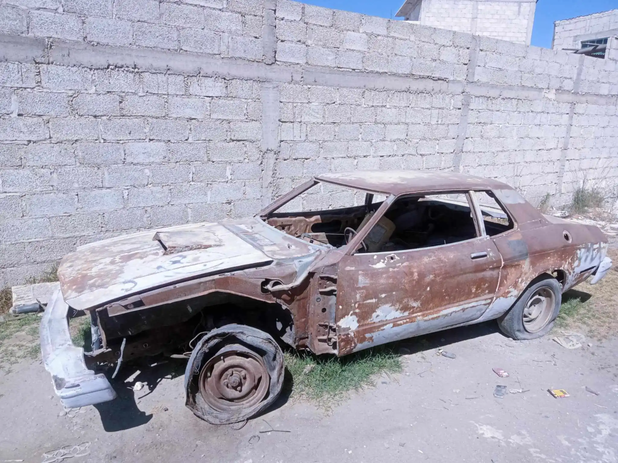

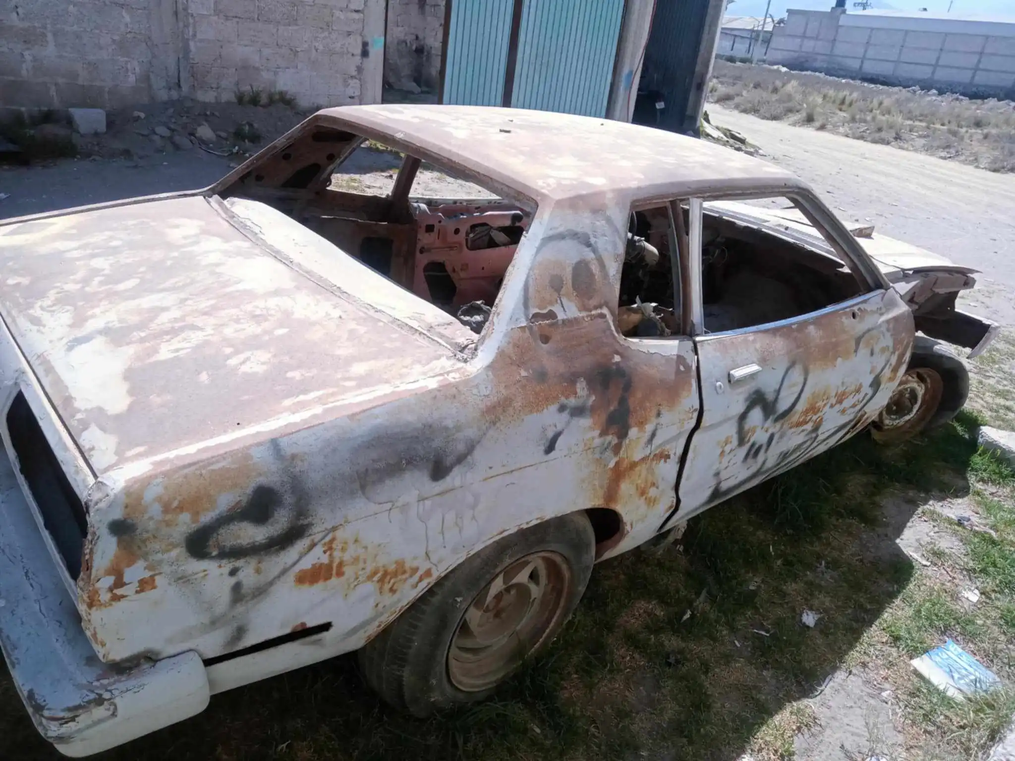

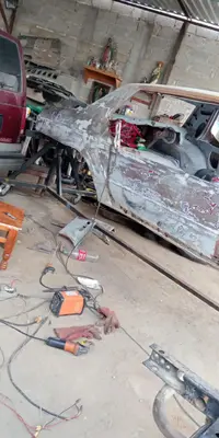

Gifted a Junk 1976 Mustang II with plans for a radical conversion!

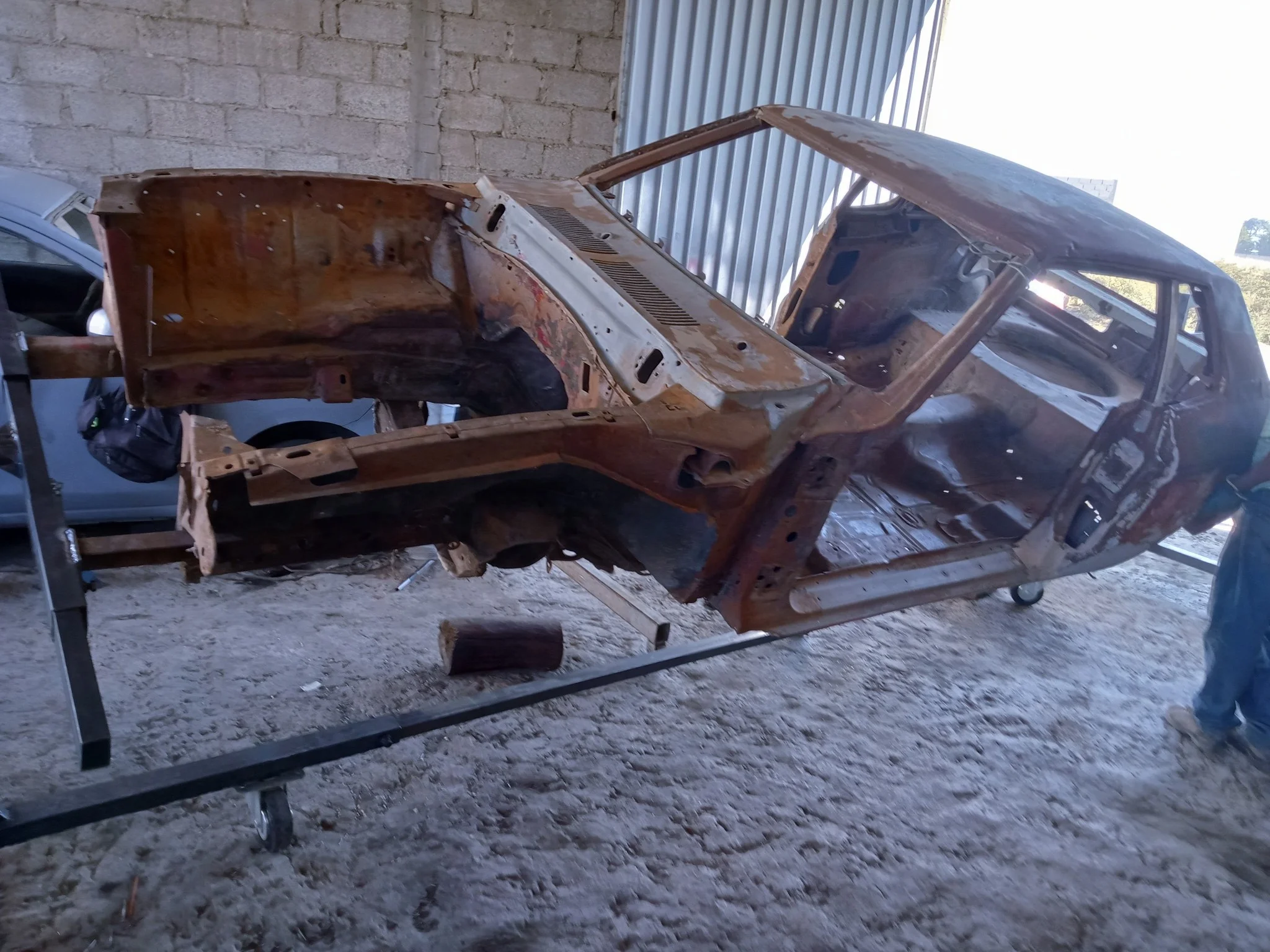

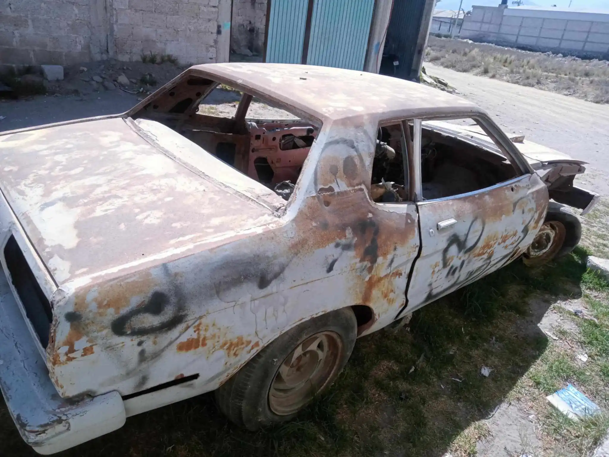

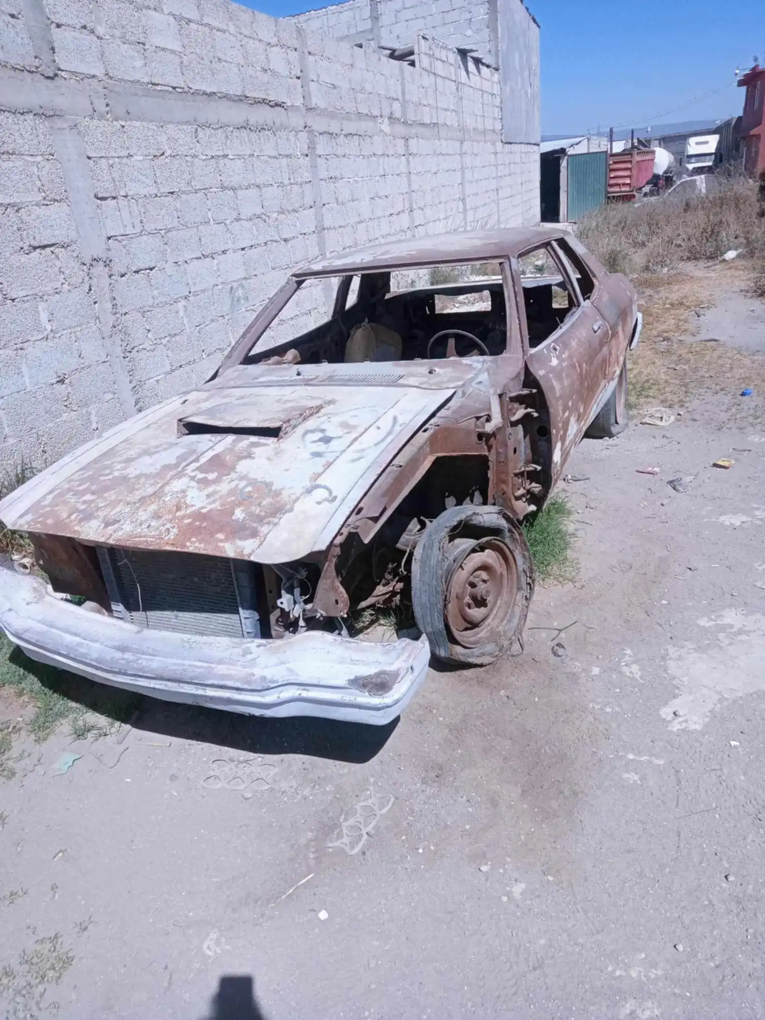

Greetings from Central Mexico. Recently I was "gifted" with a junk and stripped 1976 Mustang II having a supposed 302 engine with a four-speed transmission and 8 inch rear end. As it is already stripped inside and out, my goal is to convert it to APPEAR as an open-wheel or asphalt circle track Modified which often used Mustang II or Pinto bodies. This vehicle will be street legal by Mexico's loose standards and used for parades and promotion purposes.
My plan is to re-enforce the unibody construction with metal laminates (top and bottom) plus increase structural integrity with some form of a "safety" cage. The cockpit will only have two seats with a full, smooth metal interior.
MAJOR QUESTIONS!
1) Can the original points of mounting the engine, transmission, rear leaf springs etc. be re-enforced and used?
2) Are there any stock Ford/Mercury components such as replacing the iron 302 head and carbureted intake manifold with lighter aluminum? Upgrade of the stock four-speed transmission mated to the 302 engine? Upgrades to the 8 inch rear end? etc.
THANKS IN ADVANCE!!

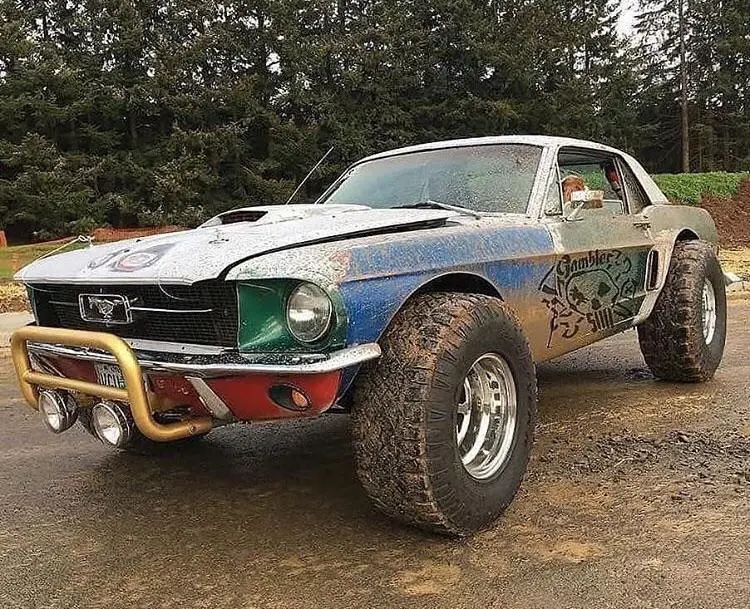

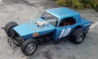

The Number 9 car is probably your best bet for a reasonable project. Lower the car a little, use wide tires and wheels, cut the fenders to fit the tires.
The other 2 cars would require building a dedicated frame to get the car that low.
Maybe you could remove the front fenders, but I would not remove the inner fender panels as they are structural. Unless you want to replace them with a structural bar on both sides of the engine compartment that runs from the firewall to the fraternal.
With wider tires and wheels up front, you definately need power steering!
Once you get it low and with wide tires and wheels, you might as well take it Autocrossing!

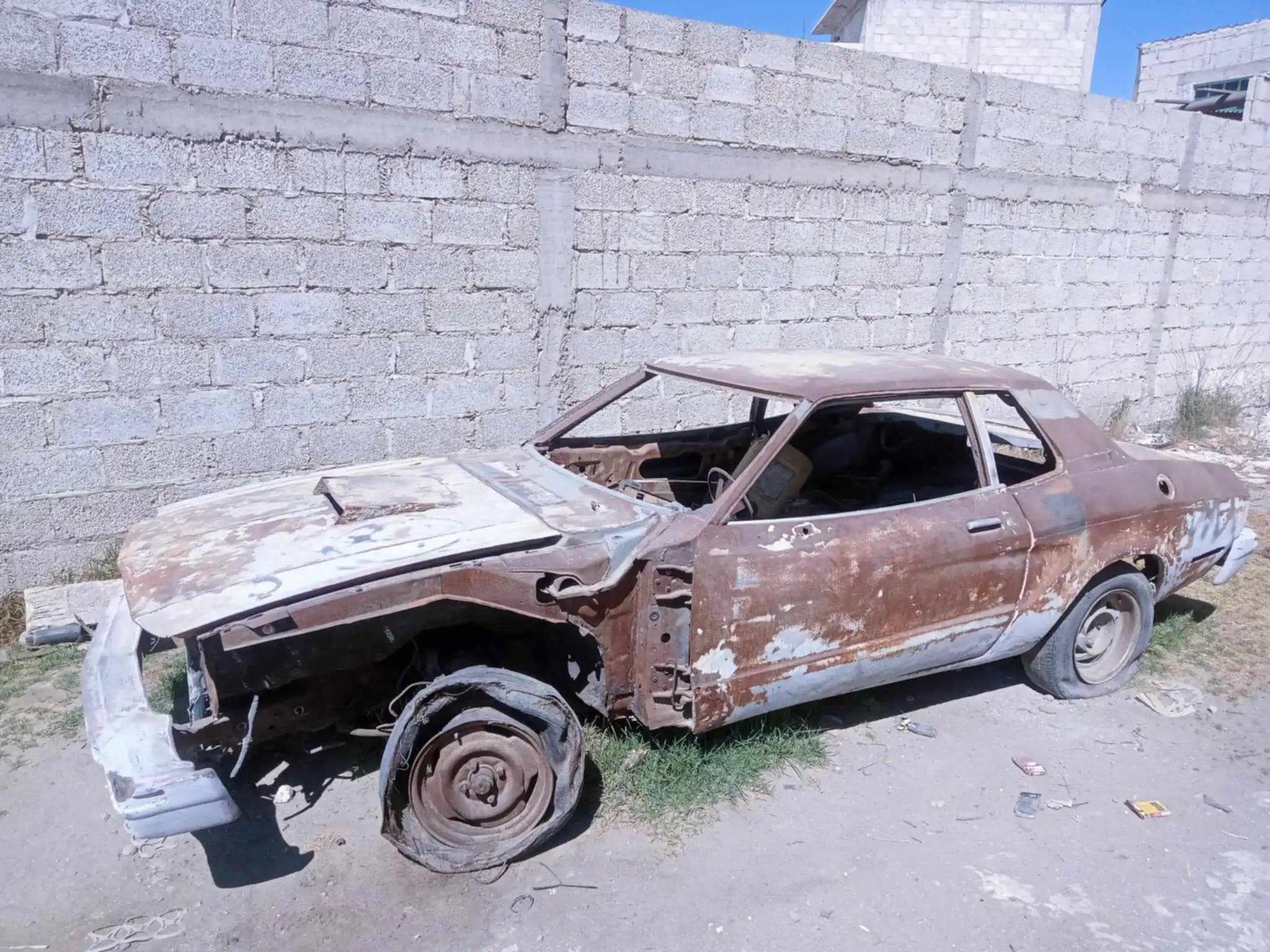

Wow - that's rough....
I'd see if you couldn't locate a pair of front fenders of some sort, cut them as you see fit, but leave the front around the headlight buckets more or less intact. Then, you can see about locating a header panel and have what looks to be a complete car. Having no fenders will complicate the front end some unless you're looking to do something completely custom - like a round tube "bull bar" type thing to attach some off road lights or something. Maybe you could use some rectangular thin wall steel tube and construct a bumper to weld the "bull bar" to as it appears the bumper mounts/shocks are still in place. Something very loosely based on this:
That would give your radiator some semblance of protection.

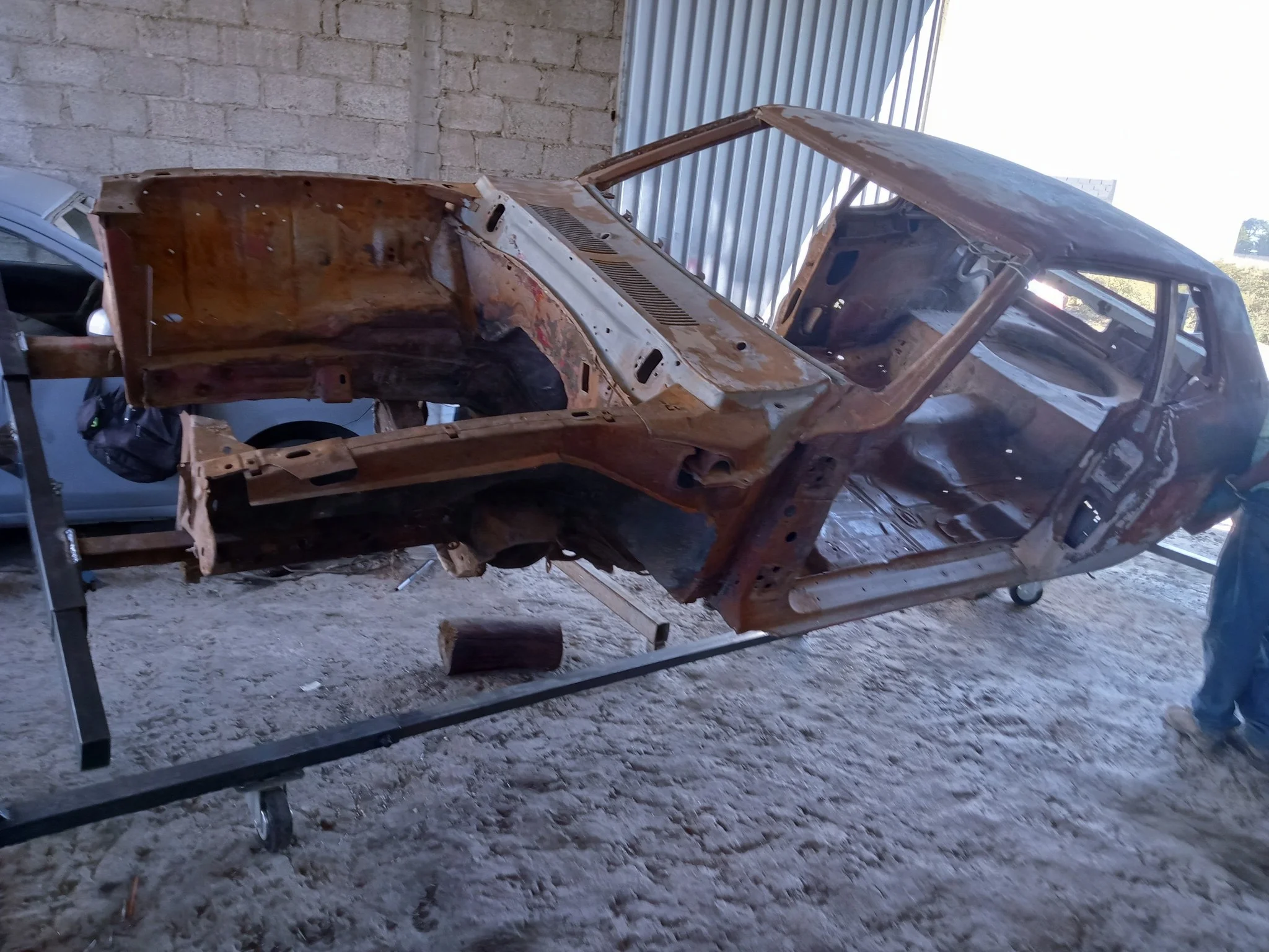

Mustang II is almost completely stripped of all bolt-on parts. Tomorrow or Monday it is attached to a "rotisserie" to allow full 360 degree access to the bare unibody.
Plans are to keep the current 302 engine but rebuild it and add mild (affordable) performance parts. Perhaps used aluminum cylinder heads to save weight. A four venturi Holley carburetor from my friend at Air Fuel Spark mounted on an aluminum manifold.
The transmission will be a performance modified C4.
I would love to ditch the HEAVY cast iron rear end and leaf springs! ha ha haa

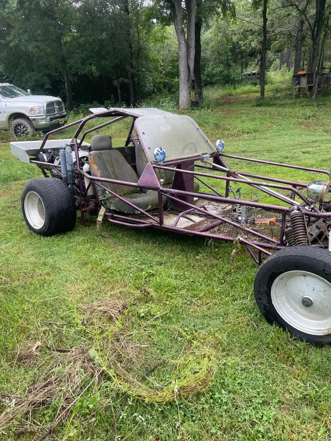

The thing that keeps popping into my mind with this thread:
Chassis Swap
I mean, through Mexico, Cali, Arizona, TX, and OK, there [has] to be maybe a Bronco, Bronco II, or some other chassis that would get you [closer] to what you want.
Hell... A fully tubular dune buggy chassis would be a [huge] score. Just weld the II body to it after you get the drivetrain and suspension squared away.
Chassis Swap
Just thinking out loud...
A vehicle with a full chassis was also my priority. It is my nephew who has a mechanic and fabricating shop who "gifted" me the Mustang II. All of the "hard points" of the chassis appear to be strong. It is all the inner sheet metal which needs cut away or covered with laminate to seal the cockpit and the trunk area.

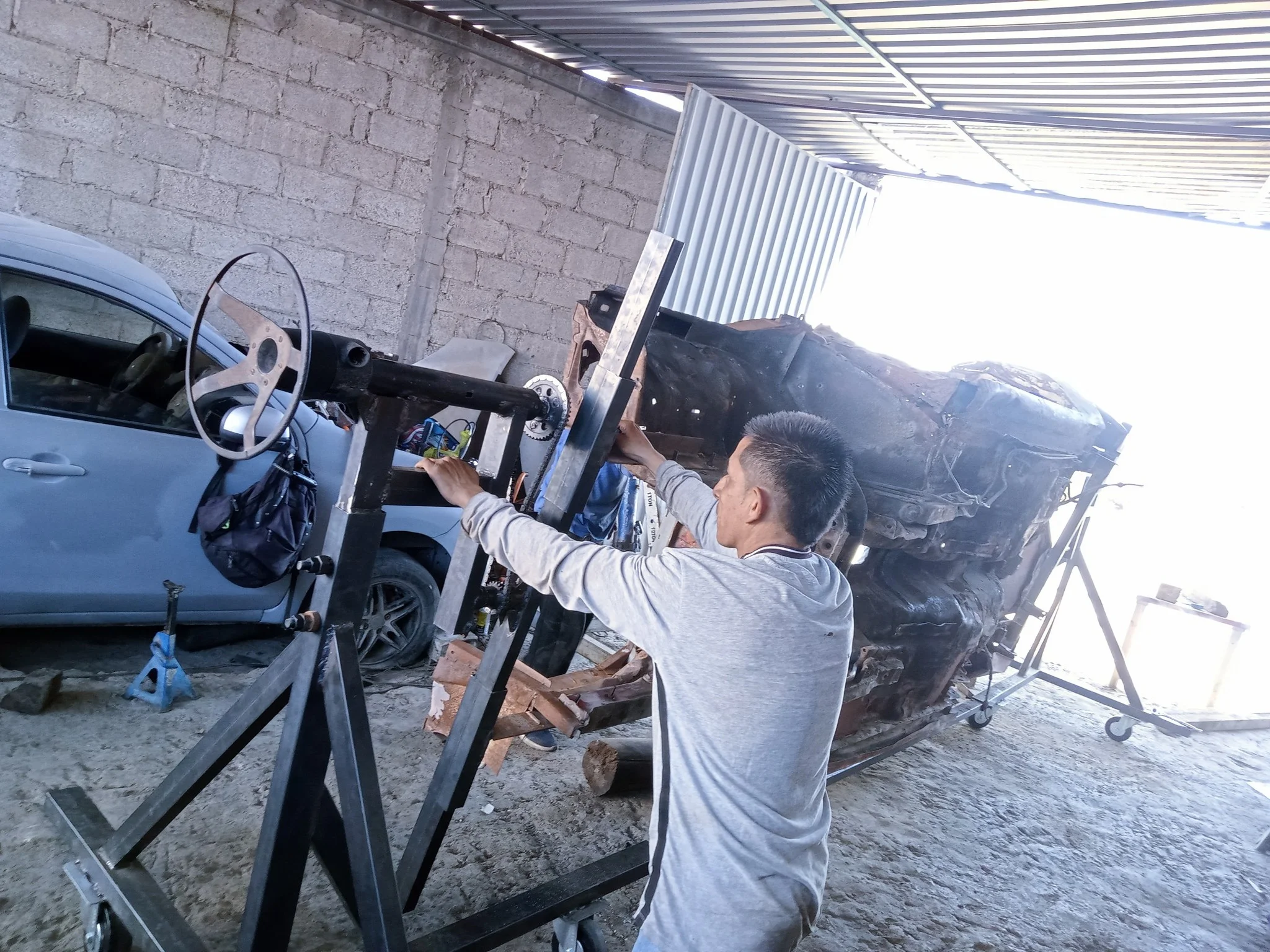

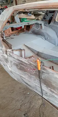

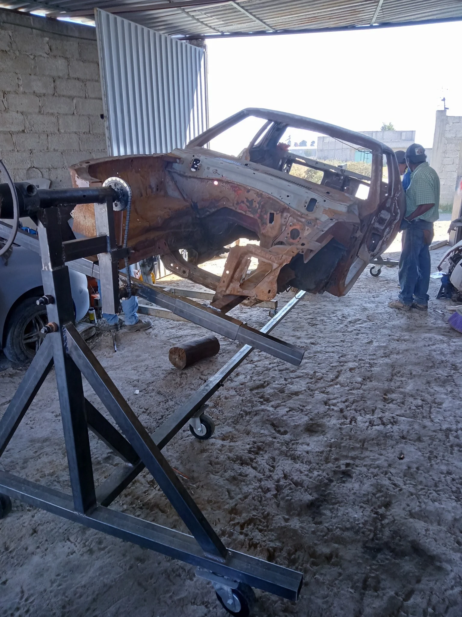

May 17 UPDATE....
Rotisserie constructed using box tubing. Mustang II is stripped of all removable weight, carried into the shop by six people, then attached to the rotisserie. We used the old steering wheel and shaft on the rotisserie to turn the Mustang II body from side to side. Two days of scraping away black sealer, 49 years of dirt and grease and now the cutting away of cancer!
The "hard point" locations where the rear leaf springs are attached will be retained. I will search for a lighter differential (7.5 inch?) having a 4:10 ratio as this will not be an all out performance build. It won't matter if comes with drum or disk brakes.
Front suspension will be replaced by a kit having modern tubular A-frames, spindles, disk brakes, etc. as aftermarket companies copied the Mustang II design for use in street rods.
I will search for a 1970s-80's C4 or C5 automatic transmission for ease of driving.
The Title shows this Mustang II came with the V-8 302 engine. Upon inspection, it appears to have a fresh rebuild and the casting numbers for the cylinder heads show 1975. They may be the larger combustion chamber (low compression) heads and will be discarded for other better smaller chamber OEM heads. I would love to get a set of aftermarket aluminum heads to save weight but it isn't in the budget. The cast iron intake manifold will be discarded for a lighter aluminum manifold. Air Fuel Spark (AFS) will supply a vintage Holley carburetor.
THANKS!
MXGerry

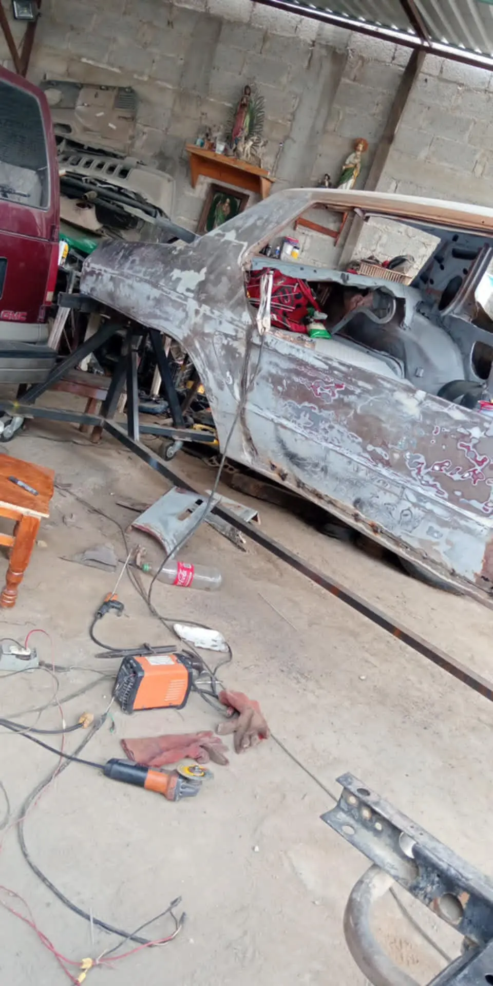

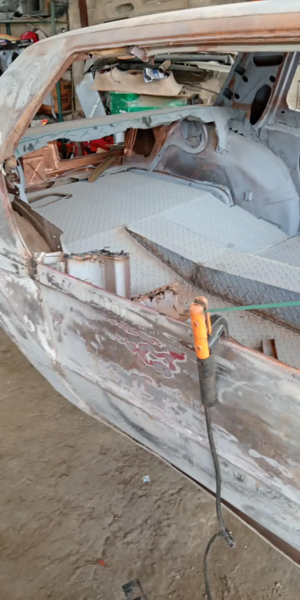

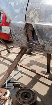

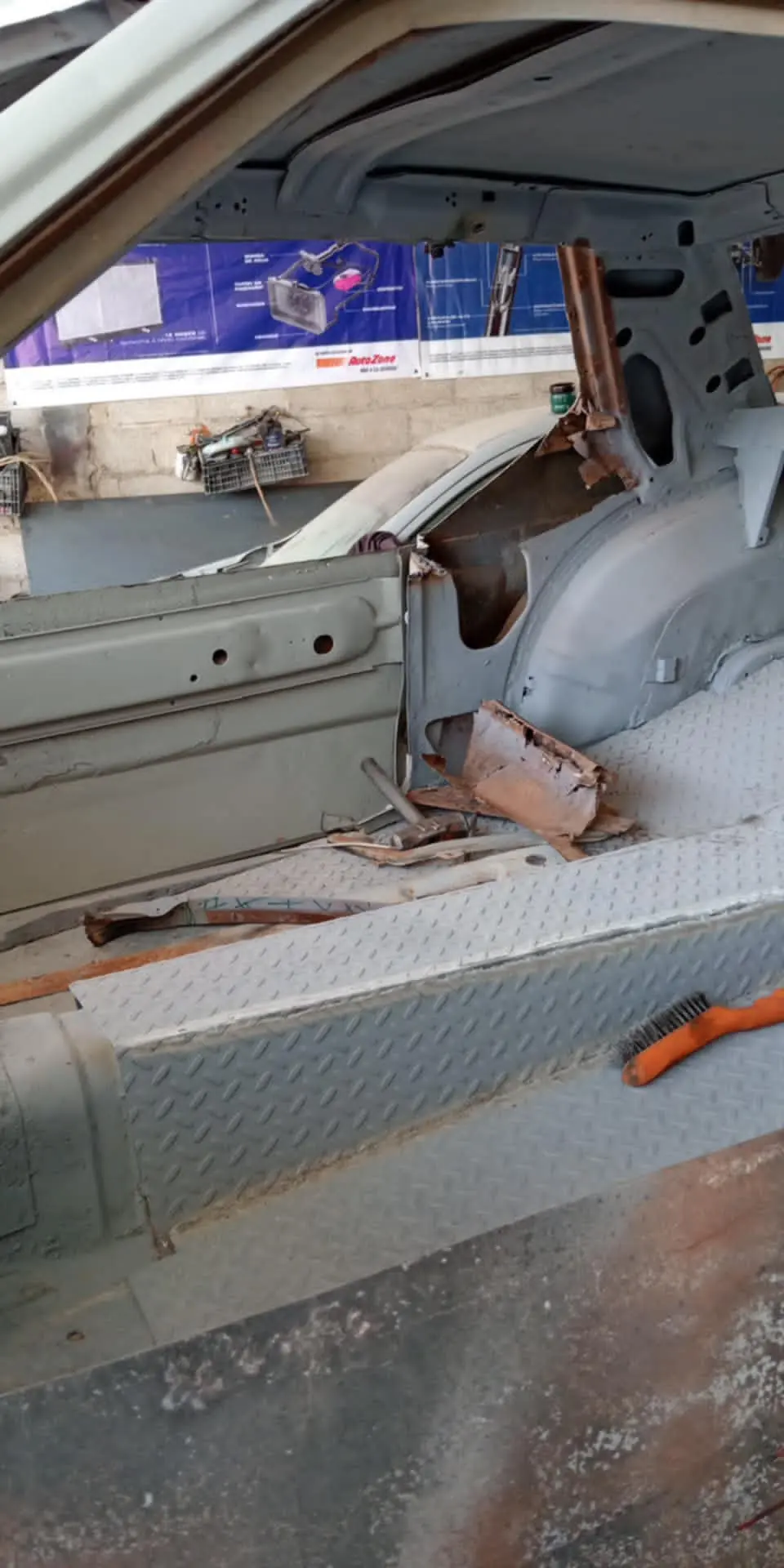

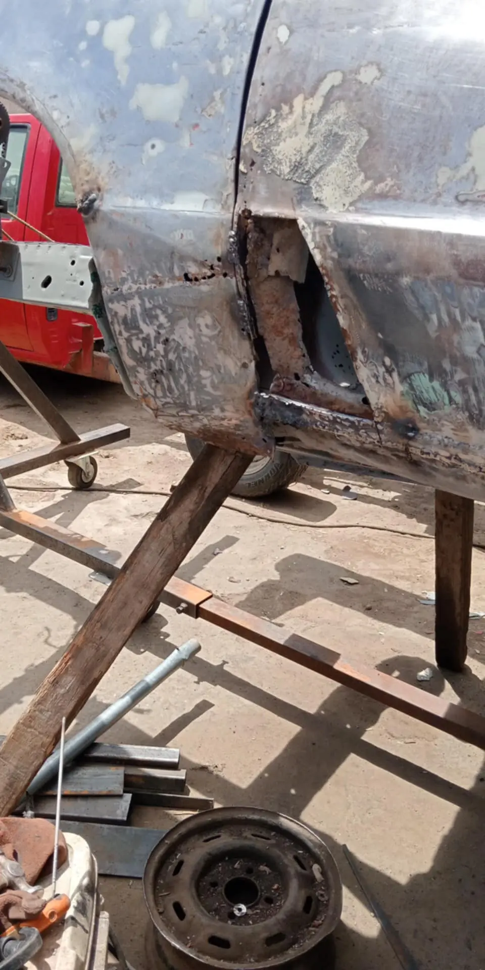

August 3 Update...
Rectangular tubing now connects the front stub with the rear stub. Flooring has been replaced with 10 gauge diamondplate steel. Doors are welded into place and window openings enlarged to allow easy entry and exit. Paint and old "bondo" have mostly been stripped away. Lower body corner pieces which held side lights have been removed with metal patches cut from them to replace lower body corrosion.
