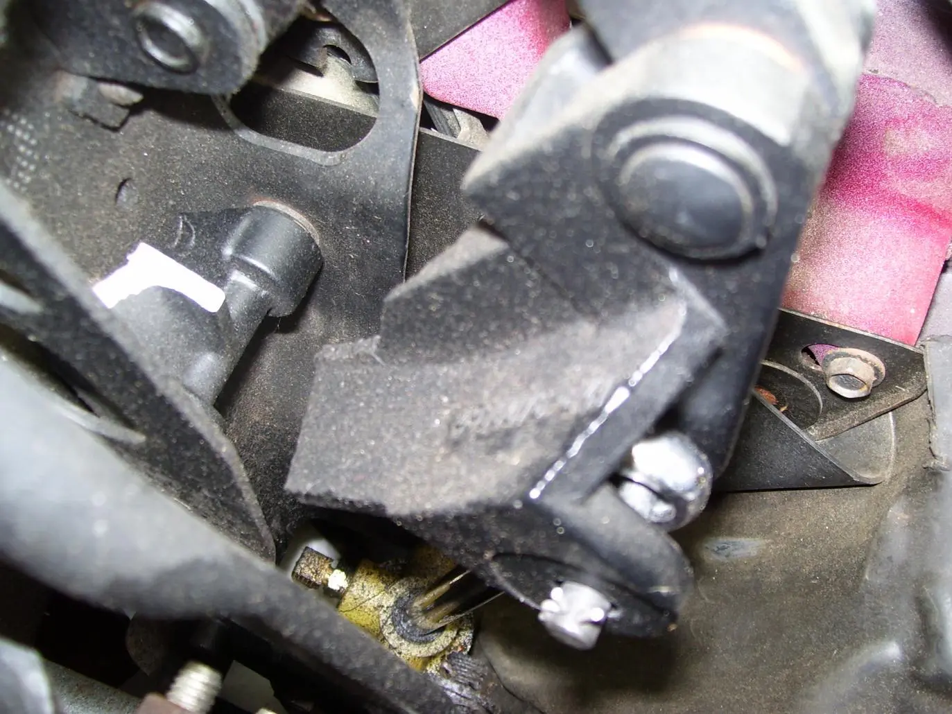

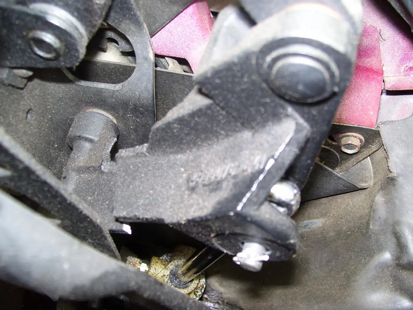

I was putting my top up today heard a REALLY loud pop, then a rattle while driving home. Come to find a peice snapped, not a clue what this peice is called but how do I get a replacement?? I included pictures. It appers to be a brace for the bracket the lift motor attaches to. Also anyone know where to get new convert frames for an 89? And if so would it already include this peice? :nonono:

I would say a junk yard. I've looked at frame parts before because I wanted to change my frame to a 93 so I could have a headliner, all I was able to find where complete frames. I don't think you'll be able to find replacement peices with new.
find a top at the junkyard. Bring a quality, note the word quality punch. Punch out the roll pins and then undo the bolts that hold the part in place. Voila. I have done this to repair several verts. Welding will not work, neither will epoxy or JB weld. Occasionally you can find vert parts on ebay as well.
