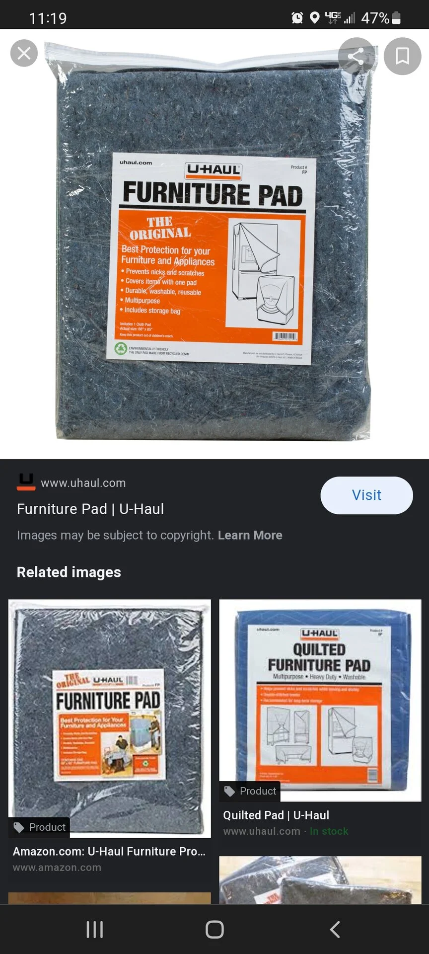

The best thing I've ever used is moving blanket material from uhaul. It's the stuff that looks like a bunch of strings a dryer lint pressed together. The replacement ones are usually just a piece of thin foam wrapped in a piece of black vinyl. The moving blanket suff really mimics the jute backing found under the carpet and in the trunk. It'll take a few layers ( 3 or 4 ) and the layers should be spray glued together with a good spray adhesive product like 3m.
I used to do a lot of convertible tops. I always hated how some new tops looked like sea horses with ribs poking out. This method I found allows you to get that nice plush look and feel.
