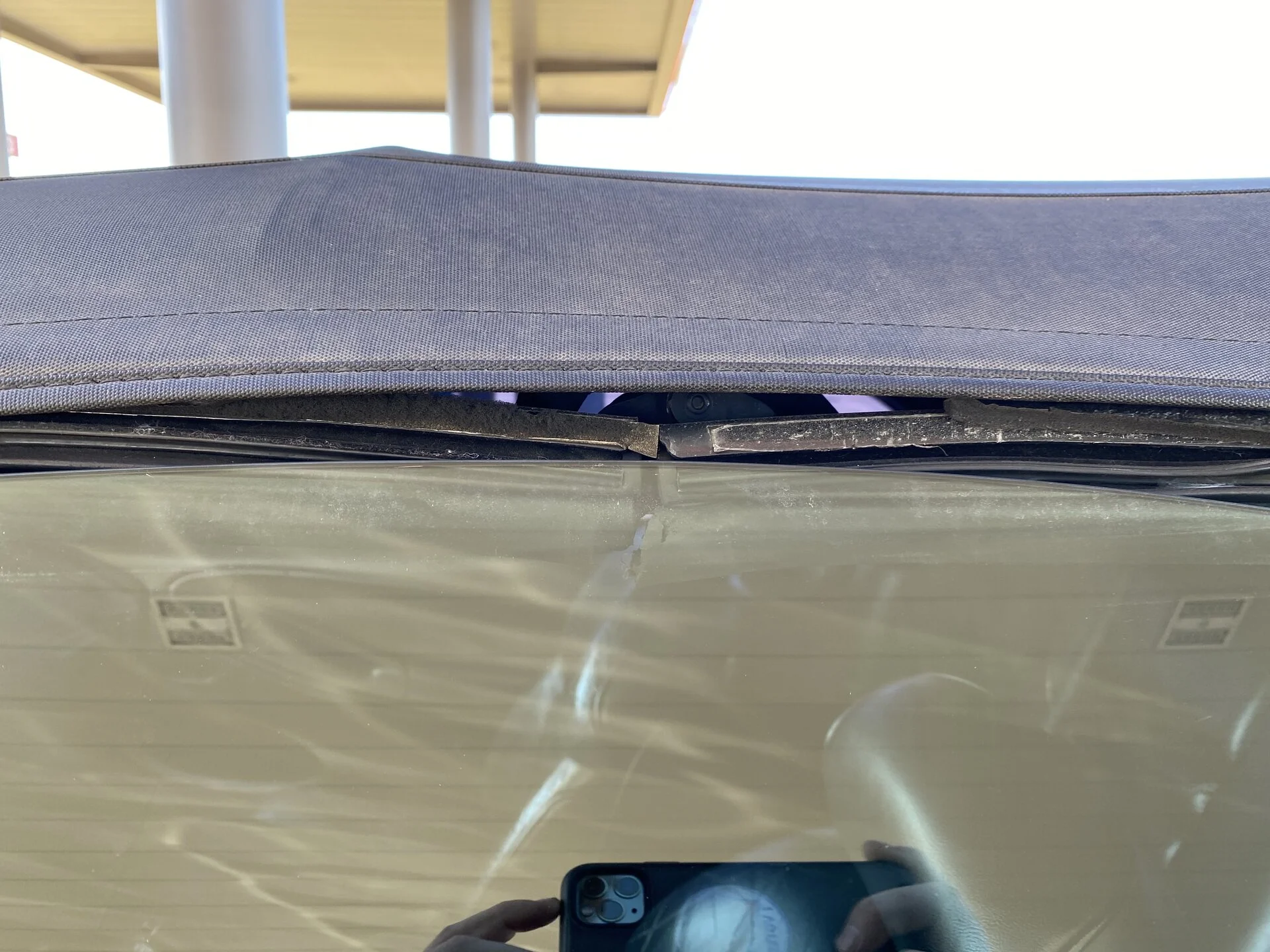

I’ve got one I just purchased that seems to be off a bit. They put a new top on and said one of the hydraulic or mechanical motors in the back went out and the door won’t shut right when then top is up. Anyone ever heard of that before? I’m not a Vert guy for the right price and top is brand new. Carfax shows it was never in a accident, and by looking it over its all original. Looks like it may have been done by someone who had a little knowledge but was told the door can be shut when it’s up, just hard to do. She said she remembers them saying something about a motor in the back maybe going out
Yes, if the electrical parts are showing age and going out it is a common thing that one side will fully extend and the other not. What I would do is take it into the garage or out on a sunny day. Put it all of the way down, then all of the way up without latching it to the frame. Once it is in the fully extended configuration, take a tape measure and see what the actual distance is that you are lacking. Because on the front there should be 2 screw hooks that actually do the latching and they are adjustable.
Please, if you can supply a picture: Top up and latched, door window up, showing where the window is meeting the top (basically the issue your having)

We picked up the car, and runs nice and looks nice. The only issue is the convertible top frame on the drivers side door is down and I can’t find any illustrations on how to get it to go back up. The door will shut with it like that, but you can’t close the window all the way. I saw one for a 2001 Vert but I’m sure they are different frame styles. I wish I knew someone who had knowledge of how to get that center portion up.
