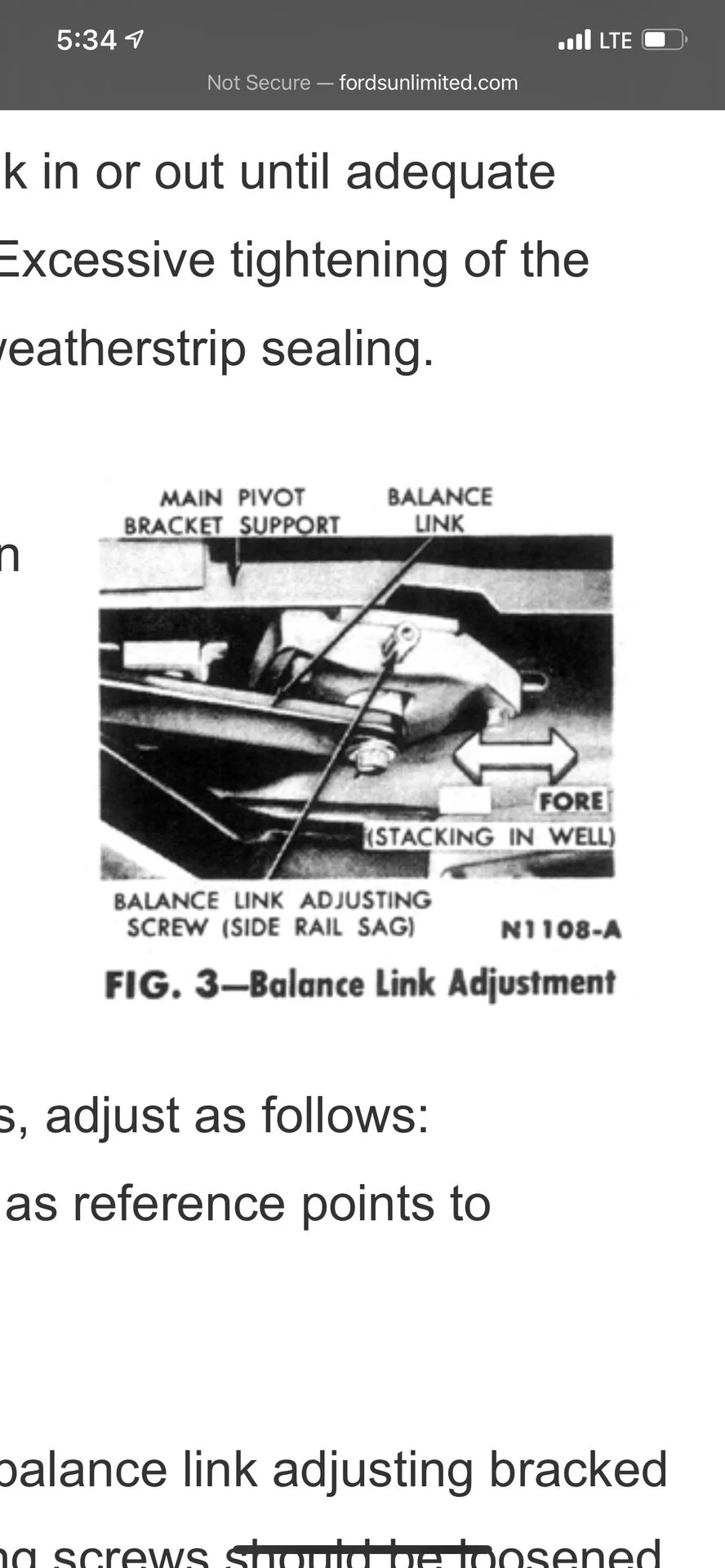

The side rail stripping on the drivers side is fine, you can see it’s just lower cause the window is cocked out some. I can’t find the Balance Link Adjustment Screw for the driver side, it’s what compensates up and down for the side rail drooping
