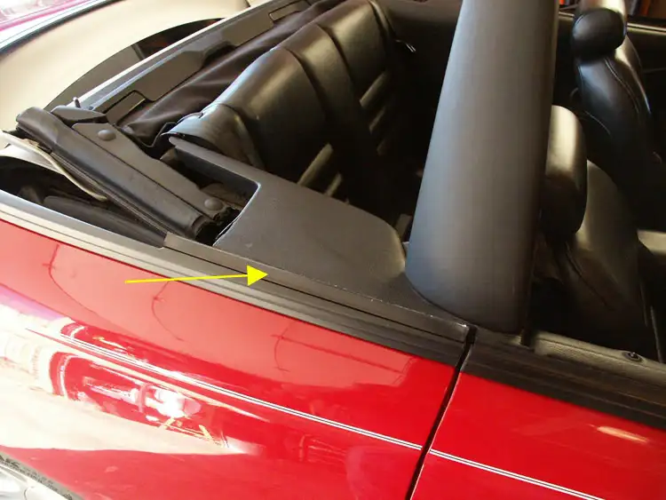

NO... the horizontal trim that is part of the body where the window slides in and out of the body panels...

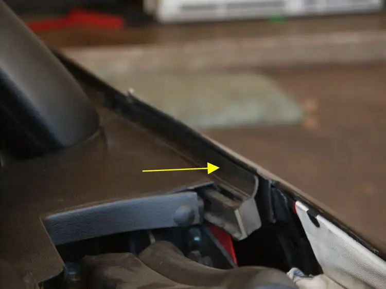

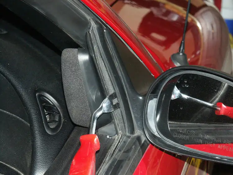

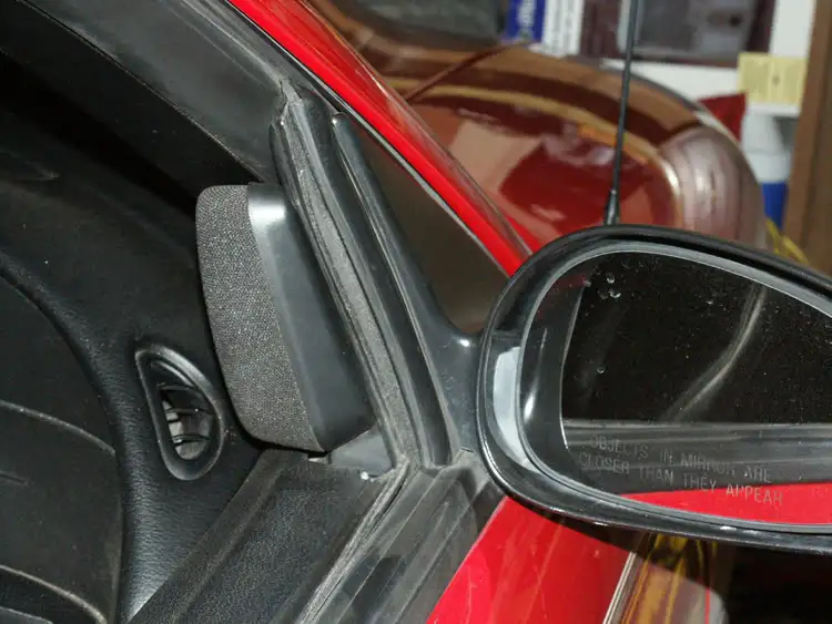

YES! Actually there is and it is a bit shorter than the pieces I've shown you. Up against where the speaker is, there is trim for the window. And yes, they are vertical... It's two pieces like I showed you but they are tucked into two other pieces of outer/inner trim.
First picture... in the front there are two pieces of trim tucked in between two pieces of rubber trim...
You can see where I'm separating the outside trim from the inside trim. Your piece looks like an inside trim...

Hey GDawg,
It wasn't the areas you highlighted in the previous picks, as everything looked good there. I believe I found the location up underneath the A-pillar. I don't have a digital camera, otherwise I'd get a pic of it. It's visible when you open the door though. I'm thinking I'm good and sure appreciate your help!!
