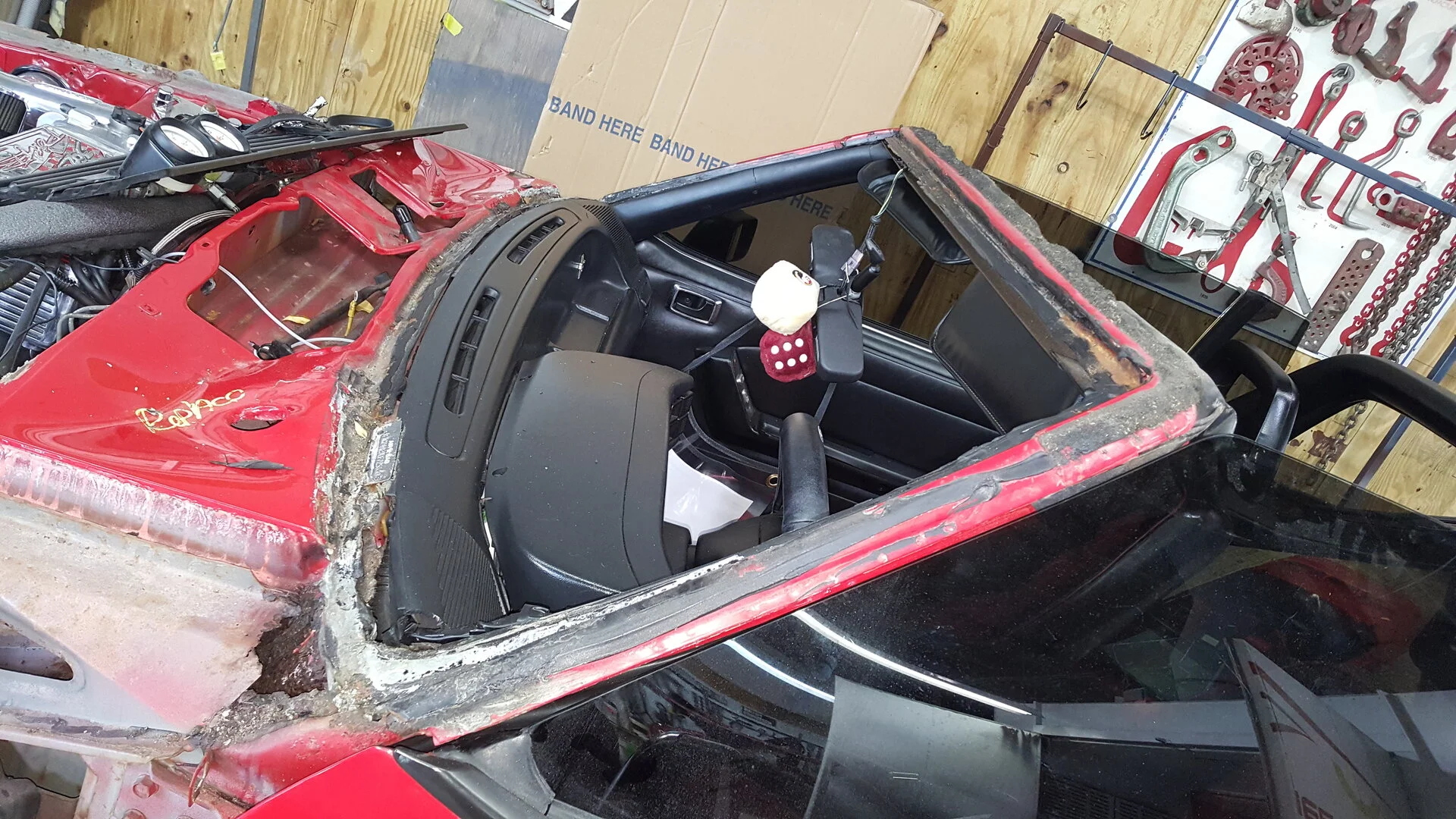

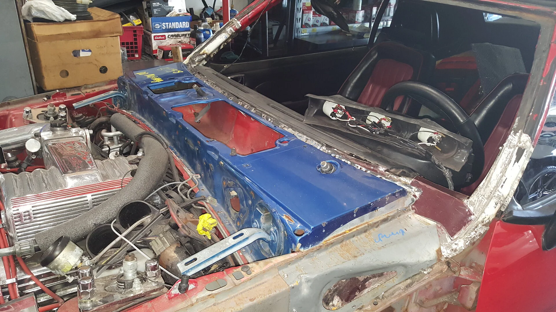

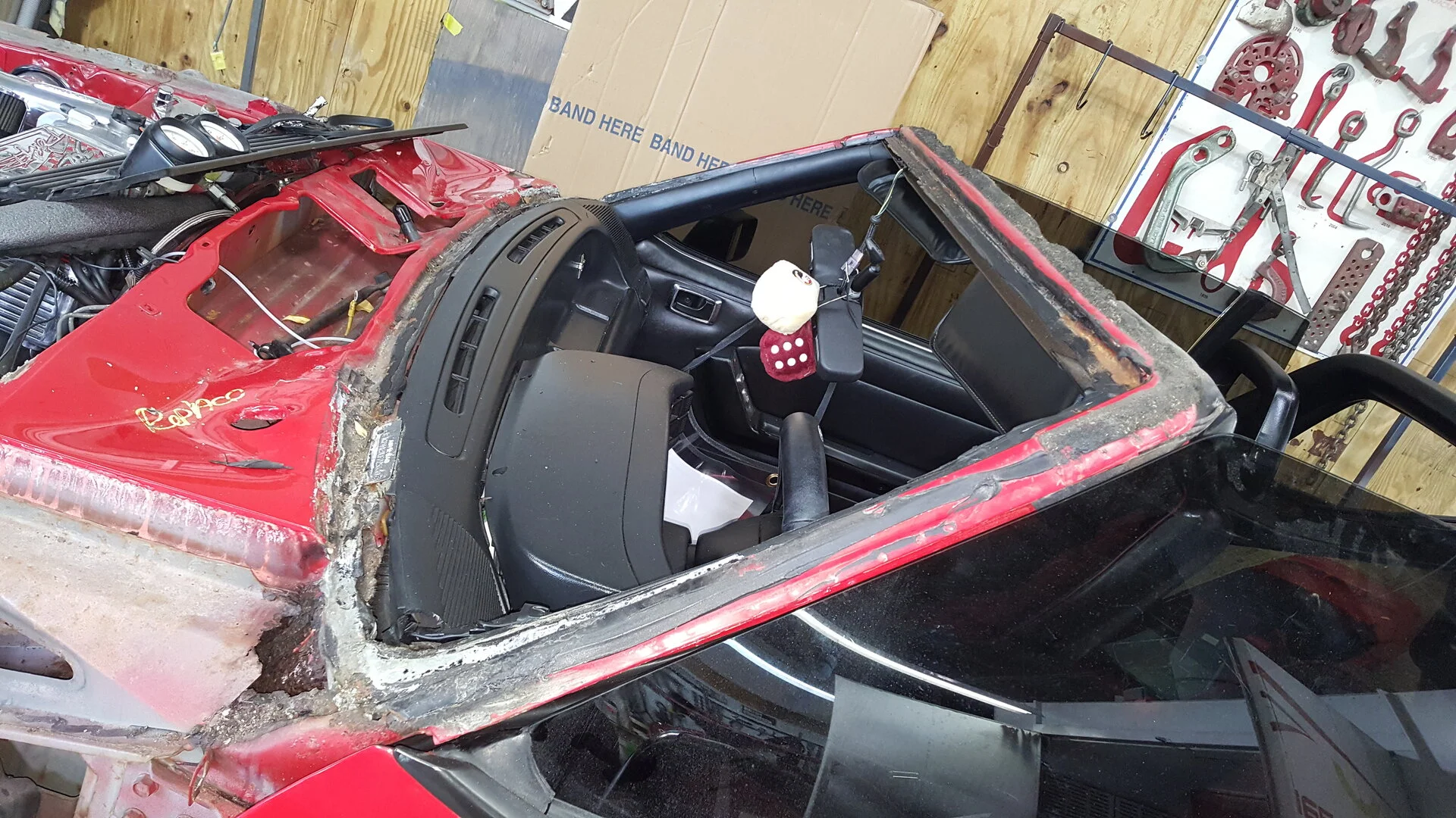

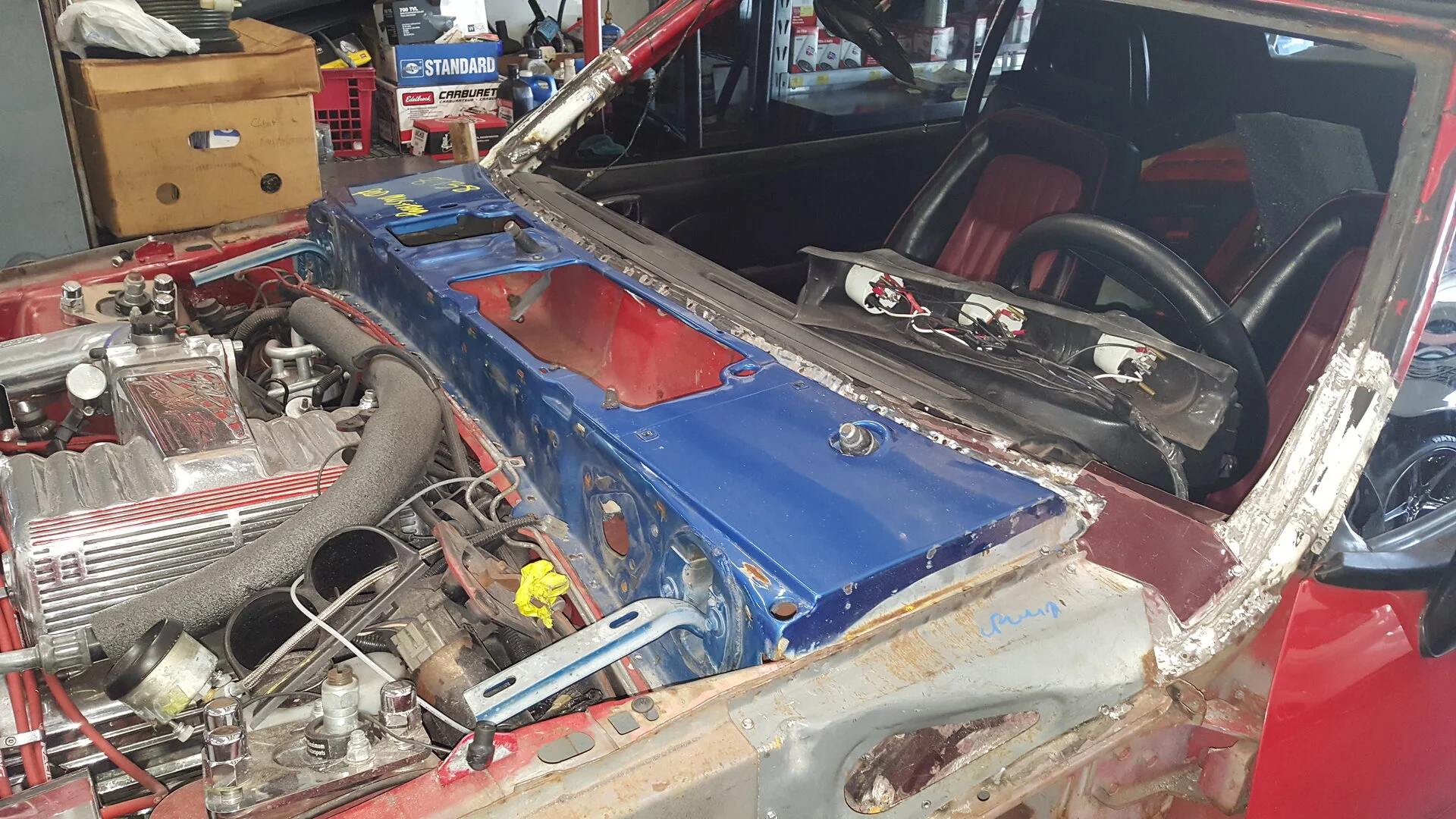

metal trim best to get from someone parting out as I don't believe they make repops. They are slid on and held on by sticky foam and tape. Top metal trim piece held in by a screw and more foam. Remove the cowl cover with 6 screws, the wiper blades and the two hockey stick moldings. You'll want to remove the interior plastic pillar pieces to gain access which come out fairly easy with screws. taking the windshield out is done by using a razor on the butyl inside and out and gently pushing on it. Two man job and often it cracks even if you are careful.
Can you get the hockey stick molding along the cowl out without removing the sides? I need to paint my cowl and I'd prefer to pull those off and replace.
yep, easy. After you remove the plastic cowl cover they come out easy using a plastic body molding tool. the hockey sticks slide into the bottom of the metal windshield trim.
