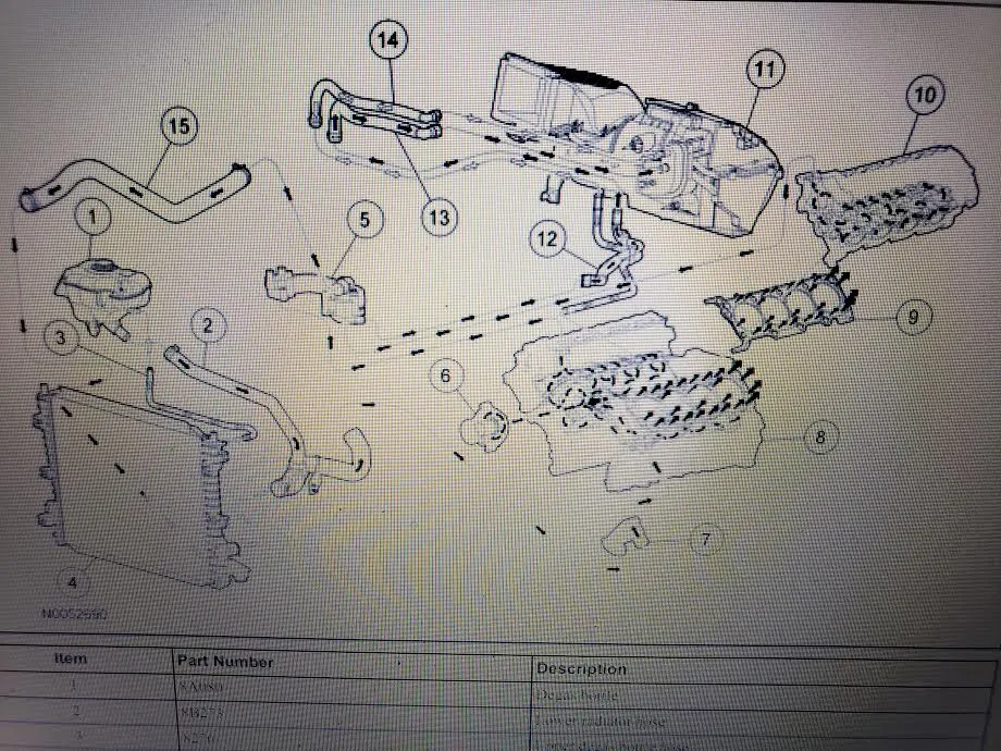

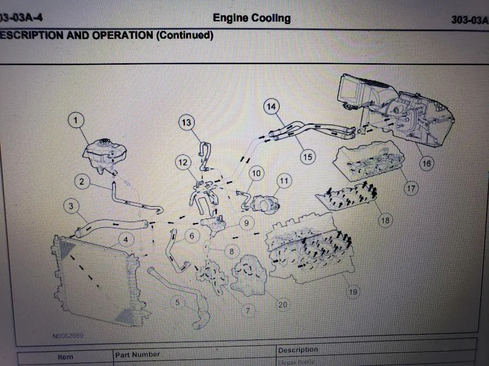

Coolant leak help please

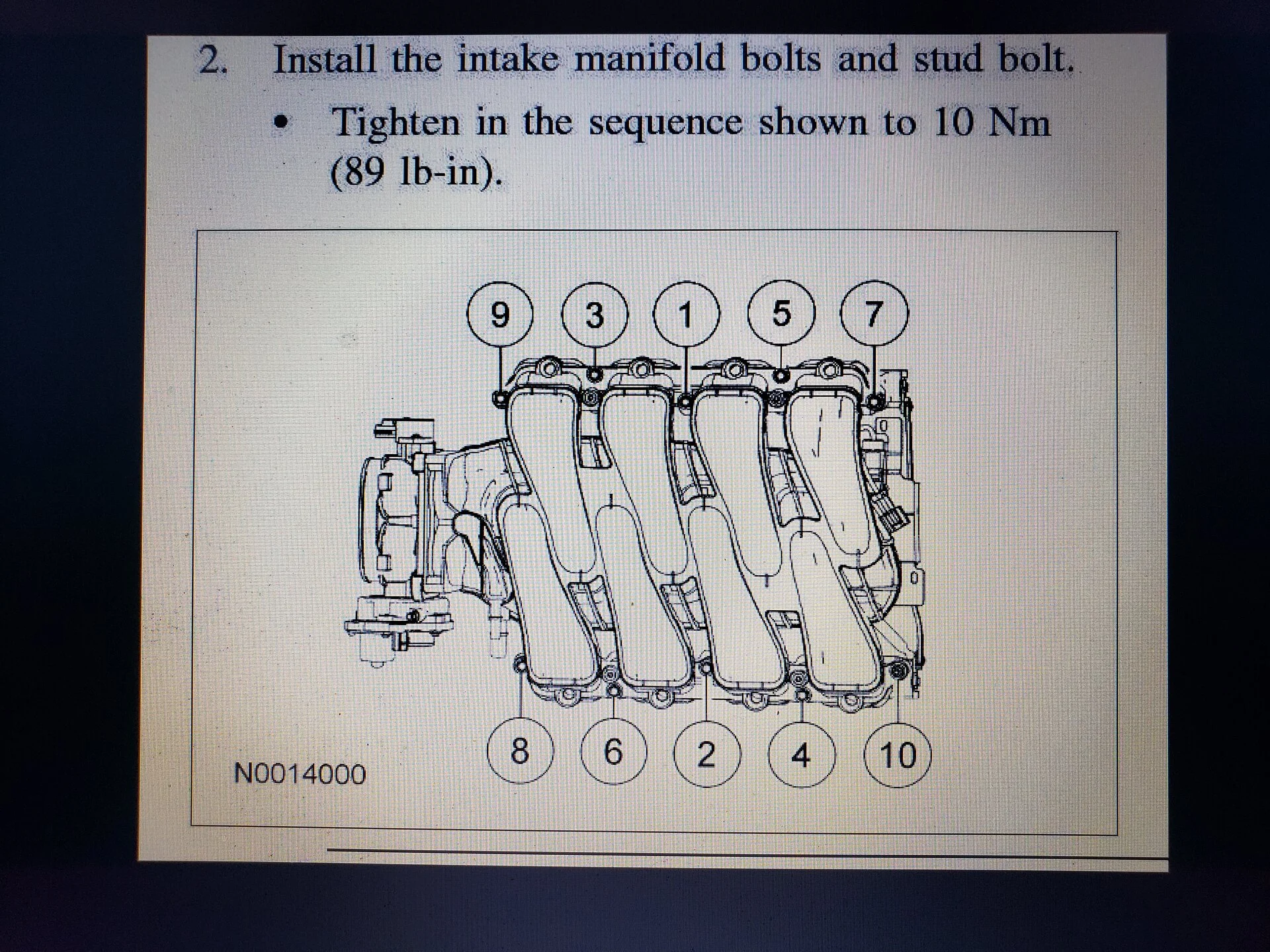

I own an inch pound torque wrench but do not use it on these
I use a 1/4 inch ratchet and tighten in sequence until you reach tight with the insert contacting the heads and then snug them up a bit more by feel. You may want to use a torque wrench for a while just to get a feel for torque. I want mine tight and will use the top of the torque range. When you go to remove yours you will find most of the bolts are way loose and removeable with just a nut driver.
Good Luck Fairly easy job
