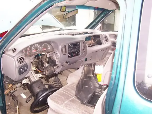

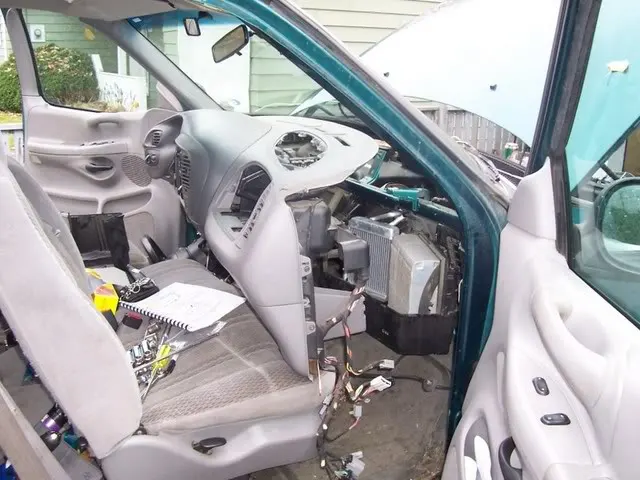

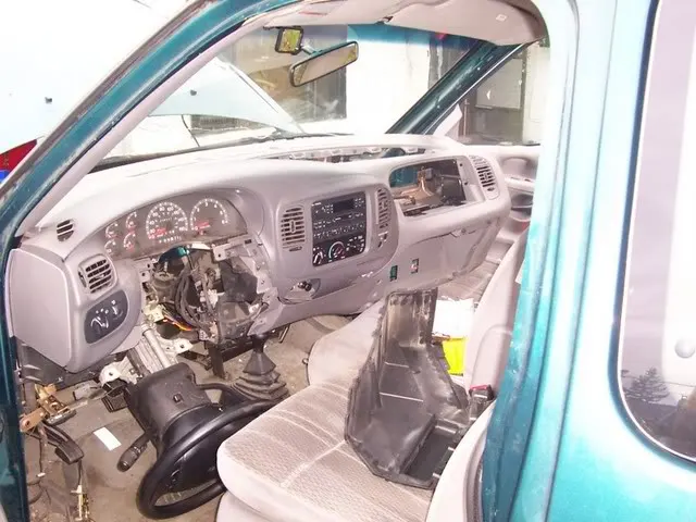

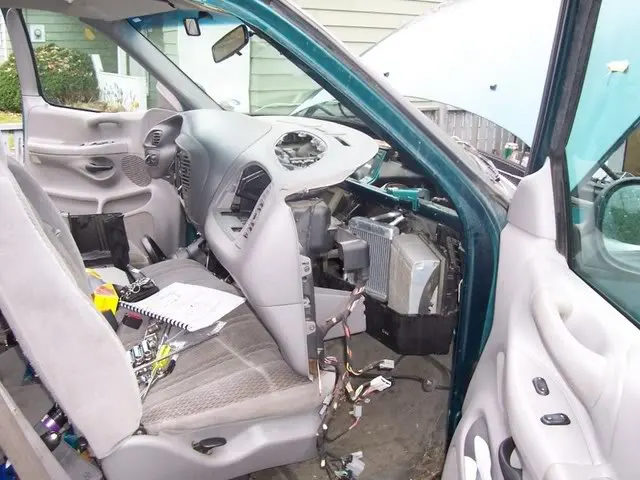

Don't feel bad. I had to do the rad and and heater core in my truck two weeks ago. Would have cost close to two grand at the dealer. If you haven't seen the pics, here they are:
Steering column and dash had to come out
All in all it was a 7 1/2 hour job to do both. If you are ambitious you should be able to do the heater core in about 45 minutes.

Heater core is one of those things where if you can see it, you should probably go ahead and replace it.

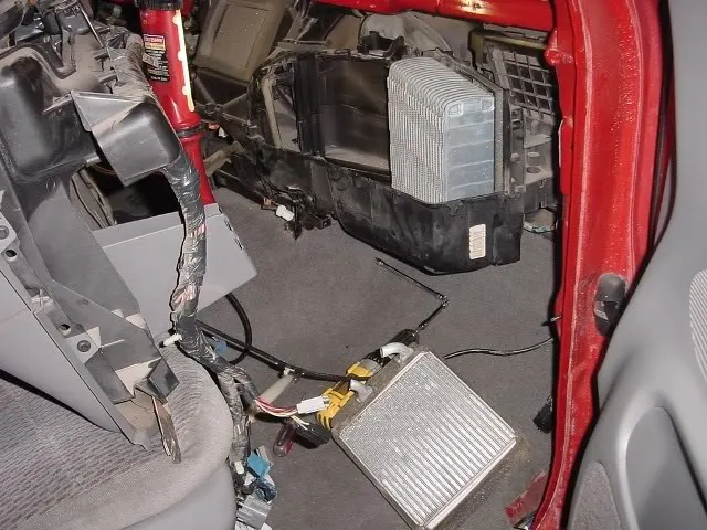

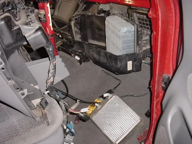

Quote by Krash:
lol, yeah, I changed the one on my sons '98 F150. You can't help but get out the camera and take pics, when you get that far into it. :lol:
the dealer here only quoted $575 plus parts. I did it for $150. It wouldv've been less, but the PO cut both heater hoses to bypass it. :bang:
