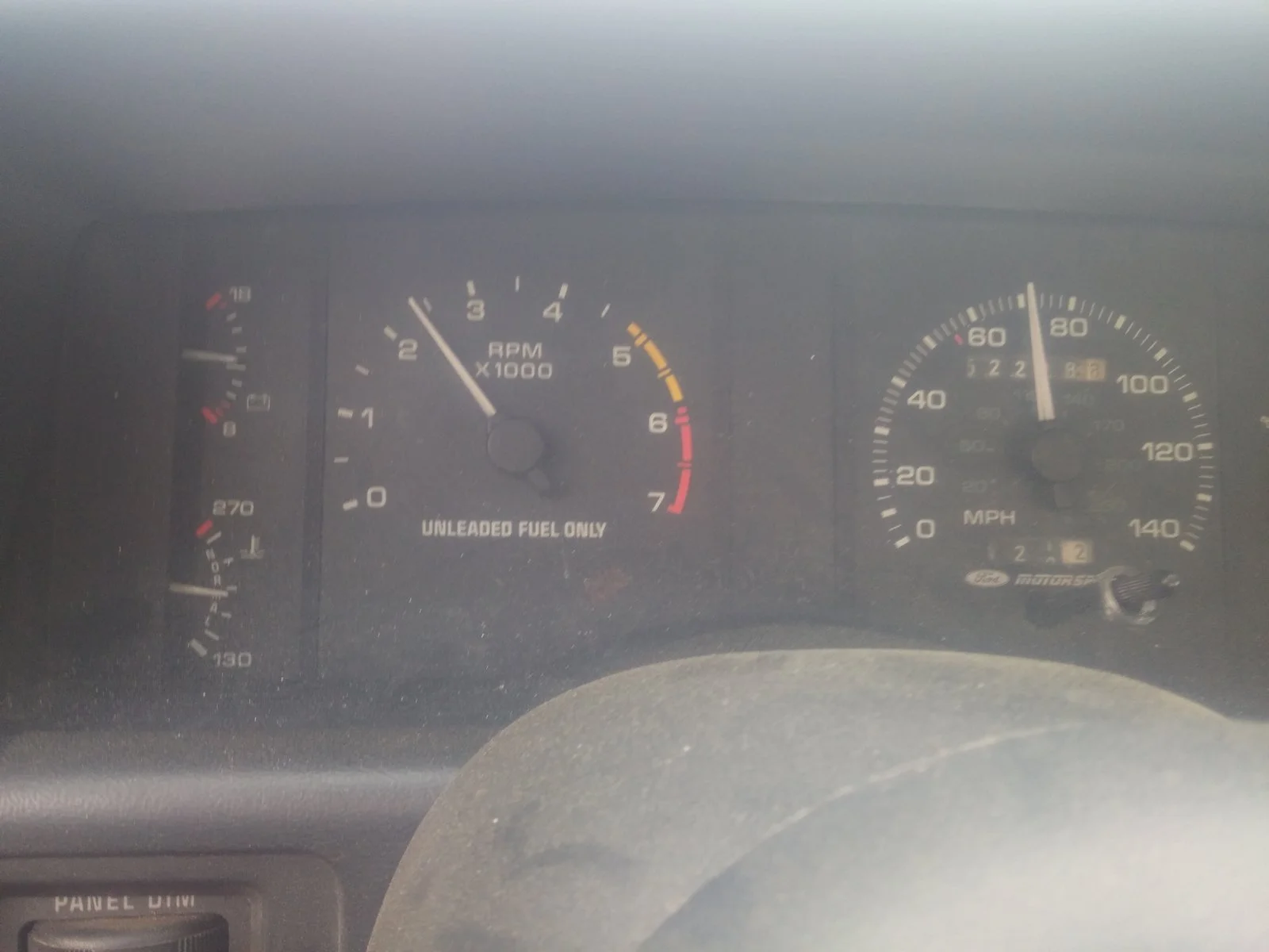

The attached image shows the place it rides in warmer temps. This is how it always rode prior to me noticing the temp fluctuations. In colder air... it will ride up to the middle mark or ever so slightly above that.
Something else that came up in a conversation with a mechanic friend of mine this evening was how it also idles differently between the hot vs. cold air. In warm air... it holds a perfect 850 - 900 rpm... but on a colder day (50ishF), it idles around 650 - 700.
In that conversation we went back to the ACT, MAF, MAP, O2 (all relatively new with the exception of the MAP & MAF) etc etc etc and their roles in the A/F map and the code being thrown for 63 (TPS) with the key off. We're tossing the idea that there could be a short somewhere and that's reeking havoc on everything. Going to chase this electrical demon down for the time being to eliminate that as any sort contributing issue. Just really annoying and stumped with the reverse order of things. Would expect the opposite from the cooling system.
If that doesn't resolve some issue, will definitely have to get an aftermarket gauge to log numbers and re-approach it with hard data.

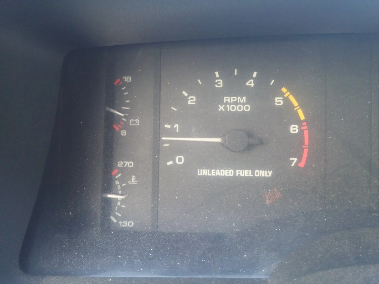

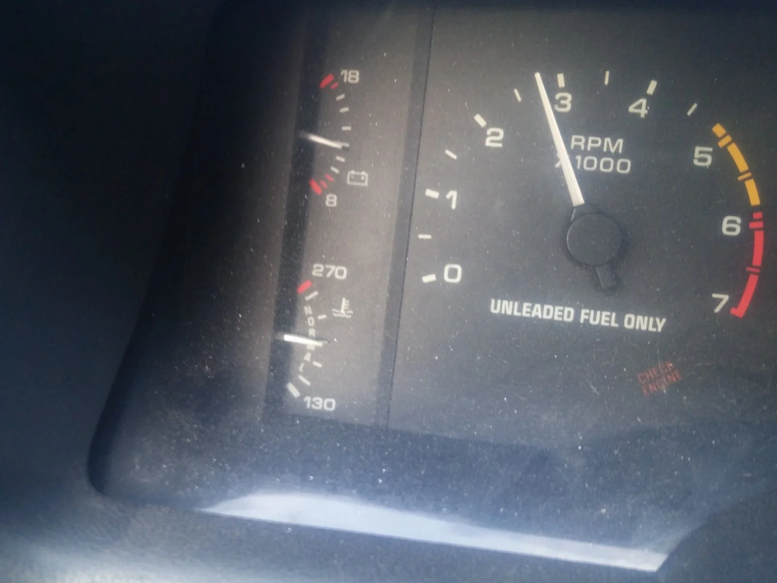

For reference, I took a couple of pics this morning on the way to work. (50ish F)

Your gauge temp pics look normal.

Back on track though, I got to thinking about a way to ask the question to hopefully eliminate the potential of spiraling and the best I could come up with is this:
if we assume for the sake of discussion some things:
A) The stock gauge is accurate
B) The middle mark is 200F
C) Normal driving conditions
D) 50F ambient air causes the system to run at 200F
E) 70F ambient air causes the system to run at 190F
With these variables assumed for the sake of this topic... how is it possible for this to happen? (I'm simply trying to understand this concept)
The only way it makes any sense to me is that there is a wiring issue somewhere that is somehow affected by ambient temperature and causing the fluctuations I'm seeing. Maybe a crack or leak internally that only manifests itself in cooler conditions?
