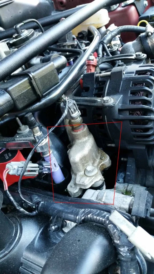

Hey guys, I had some coolant leaking onto my fuel injectors/COP, and I found where it's coming from. I tried tightening it to no avail. I assume I'll just need to replace the gasket or something. I circled (badly squared) where the leak is coming from, I just have NO IDEA what part it is haha. The thermostat is on the other side of it, and it goes around the radiator. Thank you in advance!

Hate to say it friend but you may be looking at a new intake. Unless somebody has a new trick for leaking crossovers, you need to replace it. It's a petty common problem on these cars.
