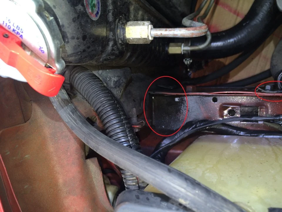

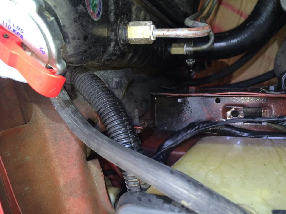

Hi,
Just picked a 85 GT Vert, drove it home which was about a 30 mile trip and saw steam coming out of engine and could hear the coolant boiling. Turns out that the coolant is leaking pretty bad but cant figure out where its coming from. Hoses look in tact and its pooling on the drivers side, take a look at the pic and let me what you guys think. Any help would be great!

steam out of the engine? Explain- what did the temp gauge go to. I can't tell a thing from that pic. Any white smoke or water from the tailpipe?
1. I'd be taking the car back and get my money back-
2. it could be anything from a bad hose, cap, thermostat, overflow tank, radiator, water pump to head gasket
3. If you are keeping the car- go to Autozone and rent a coolant pressure tester and coolant exhuast gas tester
Pray to the car god the blue fluid in the test kit doesn't turn green.

This is where it is pooling up and yes there is a little white smoke from the exhaust and you can smell the antifreeze when its running

You are not going to like what I have to say. Sounds like you have a blown head gasket. The coolant is boiling out of the cap and pooling in the inner frame. Smoke and coolant out of one or both sides.
Pull some spark plugs- hope they are not white. Do what I said in my earlier post.

Yeah unfortunately I did not have it checked out, the car is very clean and when I looked at it I saw no leaks and it ran fine when I test drove it. The owner claims the car never overheated but he never drove it for long periods of time. Car only has 92k and is bone stock. The leak is constant and is leaking pretty good on the drivers side by the door onto the floor. Gonna try to get it to a local shop to pinpoint it, if it's the head gasket then I'll just take the loss and resell it

That side of the car is not the heater core. Are we looking at the recovery tank or battery on the 85? Wishful thinking, if someone over filled the system, then it got up to full temp, it could overflow the tank, piddle and puddle there and steam off the exhaust.

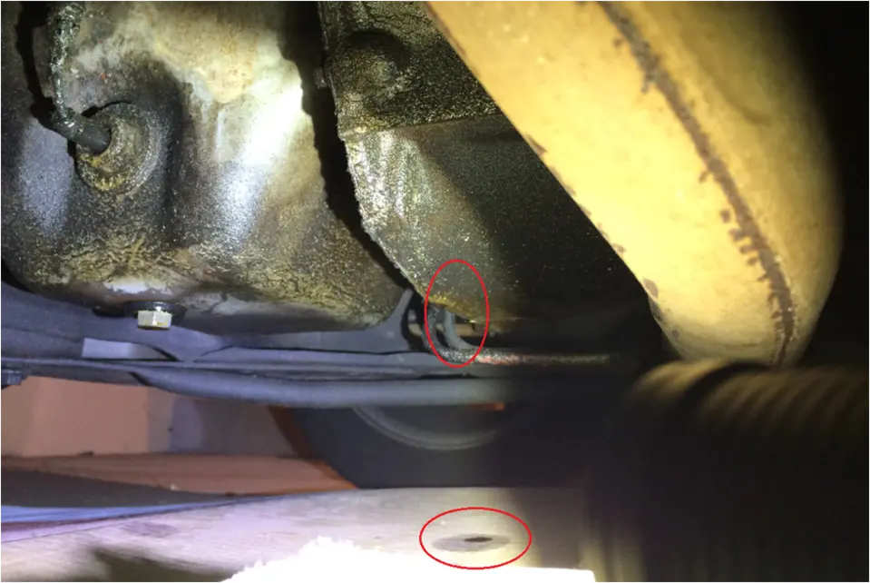

Well the water pump was replaced but still have a leak, the shop is recommending the valve cover gasket and intake gasket as well as its leaking but would it cause this leak in the picture below?

I vote to throw parts, big heavy parts, at it. The heavier the parts the better. But only if it an ugly rust bucket. If not,Ike has a good question. How did they determine the location of the problem?
On many cars, removing the valve covers makes cleaning the intake gasket surfaces much easier. On many V-8 models, the valve cover flanges get in the way of removing the intake at all. If they have good readon to install new lower intake manifold gaskets, PLEASE insist they use the steel vote ones from Fel-Pro. They end in -S. Car Craft (or Hot Rod) just had an article on sealing Ford 5.0 intakes. It looked like it was stolen from old threads on here.
