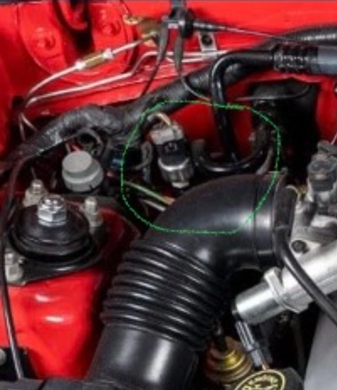

Heater core will also cause a fog on the inside of the windshield starting at the bottom. If it’s bad enough it will drip out of the AC condensate drip line just below the accumulator / dyer that is on the passenger firewall which is located here so the drip line stick out of the fire wall below it:
