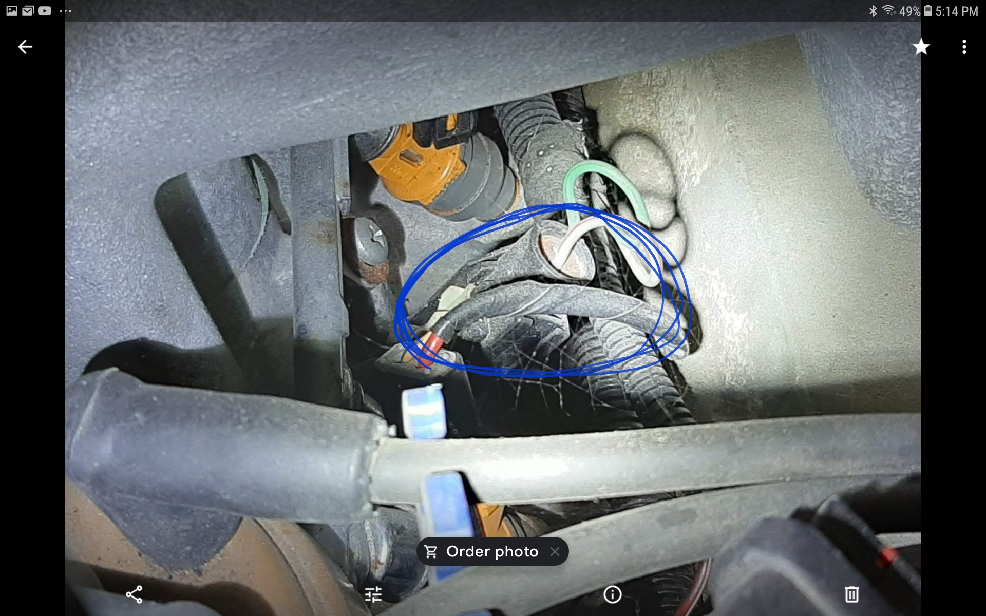

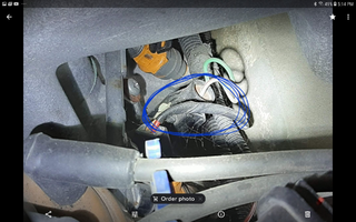

I might as well ask what this senser is & its job ? Looks like another temp senser. Maby the General could get this one being he has no wife lol.

That’s the ACT. Air Charge Temperature sensor. Measures the temp of the incoming air
Thanks,I would think air temp would've closer to where air enters intake. Thanks again,Jim
It measures the incoming air about as close to the combustion chamber as it can, just as you are about to add fuel.
