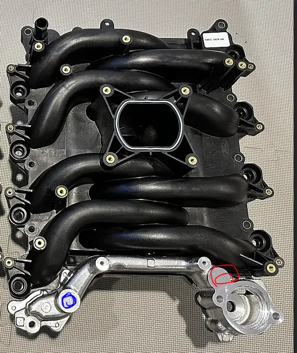

J jtmfc New Member Mar 15, 2024 1 0 1 Sacramento Mar 15, 2024 #1 Mar 15, 2024 #1 I just need to know what the sender looks like and what the sensor looks like so I can put them in the right spot on my 96 GT 4.6 now the sender is on driver side by the thermostat correct?
Mustang5L5 That is…until I whipped out my Bissell Mod Dude Feb 18, 2001 43,309 18,018 224 Massachusetts Mar 18, 2024 #2 Mar 18, 2024 #2 On 96-98 2V engines, it's on the driver's side next to the t-stat housing. I've circled in red. on 99-04 2V engines, it's on the pass side. Circled in blue
