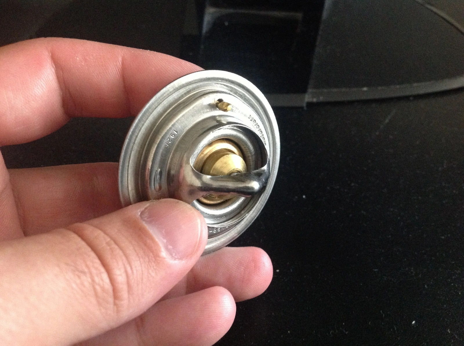

UPDATE: The thermostat, the second one from Autozone, which was a balanced 195 stat, was a dud out of the box. I took it out of the car & boiled it until 220 degrees with no opening! So far, this makes 2 bad stats, 1 bad spark plug wire set, and 1 faulty radiator cap from Autozone. I went ahead and bought a Motorcraft 190 thermostat for my car. Bye bye Autozone business. Do yourself a favor guys, don't buy parts from Autozone. Fluids, sure, but parts, never!

I always enjoy your posts. This one gave me a lol for sure. I gotta tell you though, the 2 stats I bought from Autozone were both Mr Gasket balanced stats (180 & 195). I was quite shocked! The 180 took a dump after a week and the 195 was a dud out of the box! I went for Motorcraft. They sell a 190 for my car.
I don't know about you, but when I do repairs my intent is to not go back in until I'm a lot older & much more grey. So, I installed the stat each time with black RTV and let it set up 24 hours before attempting to fill the system. Thought I was going to need a hammer and chisel. Actually I needed a 2 pound rubber mallet to get the housing off. What a pain. Lesson learned -buy OEM.

UPDATE: Got the Motorcraft stat (pt #RT-1139). It is sold as 190 degree, but 192F is stamped onto the body of the stat. Buying Motorcraft is totally worth the small extra cost. I boiled this one BEFORE installing it after having 2 Mr Gasket hi-performance balanced stats fail (after 1 week use/& dud out of the box). The Motorcraft stat operated flawlessly. It started opening at 192F & was fully open by 195-196F. As seen in the pic it also comes with a predrilled hole in the body to aide system burping. Now to install after it cools.
