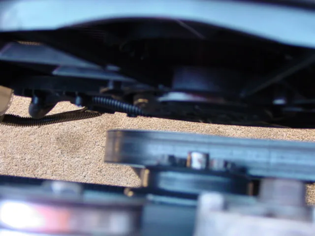

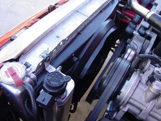

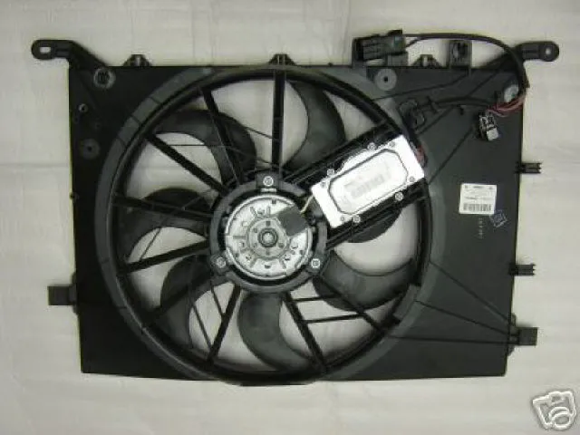

If you can find a Volvo fan like the one in the pictures below they work good.(ebay or Corral somethimes) They measure 3.75" thick and fit a stock rad great. Juts trim off all the tabs and it looks factory. Plus the stock over flow bottle can be mounted nicely to it.
I have put a few of these on , and have one for my car when I get that far. Put them a buddies blown 347 and it keeps it cool. And it fits with the 8" renegade lower blower pulley, without trimming the shroud any. Even put one a blow 331, with a Novi 2k with the 10 rib set-up and it fit with out trimming. But even if you have to trim, there is enough material on the shroud, that you could take atleast ann 1/8-1/4 inch without the fan getting to close to the rad..
If you do find one just take off the box that is on the fan and wire a plug on it. Then wire it up with a realy or what ever controler you have..

Myke86GT said:
Not sure exactly on what cars these fans came off of. But want to say the s-80's or something like that.
Here is a link to an ebay ad with the fans I mentioed above. In the pic the relay or sensor has been taken off arleady. Volvo fan for blown cars
Thank you for the reply. Most of these fans look alike to me (from a pic, I wouldn't know a 4-banger fan from a Volvo or other decent fan), so it's nice to have a reference. :nice:
