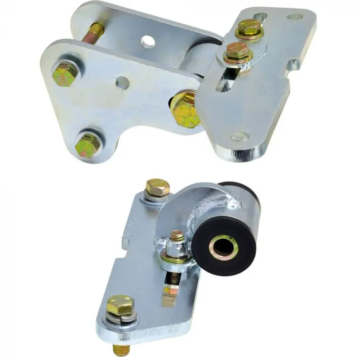

Here is a really neat engine mount set-up for an early Mustang. With all the adjustments to engine location available with this mount, who would ever even know where the stock engine location is? It's easy to slide the engine back toward the firewall, as it uses a slot, rather than holes. This is a good thing when it comes to road racing and drag racing, and a bad thing when it comes to header fitment. First, the header hits the engine mount, and second, the rear primaries hit the firewall. We have several customers that use this mount (if I recall, it's part of a Mustang II front suspension kit). Of course they notified us that the headers didn't fit, which required that they mark the interference areas with a Sharpie and sent them back to us be modified. They paid for that service, of course, they were just happy that we could modify the headers for them.
