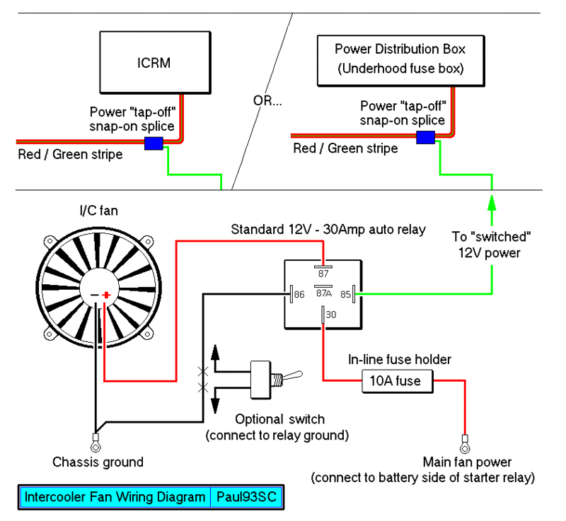

If you are going to wire in a relay, and I know you will, right? You need to get a soldering device and learn to use it, butt connectors are ok but not for high amperage devices like relays and they look like amateur crap.
http://www.allfordmustangs.com/foru...fan-relay-schematic-circuit-breaker-added.jpg

What is a circuit breaker from battery? and 12v fused? And I can solder no worries

Both fused wires. A fuse is a type of circuit break. A maxi fuse (like the kind you use for a car audio amp) will work fine for the main power line for the fan. A regular mini fuse for the control power.

This may make more sense...

Alright I got it all wired up but the relay just beeps Any ideas?

Beep??!! Ok then. That's a first for me. Should make a "click" when control circuit is energized. Something is either wired wrong or the relay is bad....

GOOD NEWS. I got the fan working. Bad news started the car and the fuse in the inline blew out
I was using 87a to power my 3 prong switch with led so that's why it wasn't working. I hooked up a wire from battery straight to switch and pulled the wire from 87a and the fan booted up. Should I run another inline fuse to switch power? Or would I be able to splice a 18g wire into inline fuse/relay wire?(if that makes sense).

If anyone every comes across this follow this picture for wiring BUT remove the inline fuse. For some reason no matter what you do it'll blow the 30amp fuse non stop. I let the fan sit on for 30 mins with car running and no inline fuse while I was checking for smoke from fan motor, burning wires on relay/fan/battery/switch and there was nothing going wrong. If the fan motor pulls to much power the relay should stop the connection till the voltage drops or w.e I read about relays lol.
But thanks Dan for the help with the schematic! And everyone else who's helped me with this!

Pretty sure the stock fan fuse is 60A which would explain why you're blowing the 30A fuse.
I'd put one in the circuit to keep from melting your wires should something short. And make sure the wires and relay are rated high enough for 60A @ 12V.
The relay will eventually sacrifice itself (by melting its terminals off) if there's too much current. That's not reliable protection though, and it won't get better after the current drops, you'll need a new one.

Everyone told me 30a Okay I shall get a bigger inline fuse with a 60a and set it up that way! I don't want anything melting lmao. Thanks for the tip
