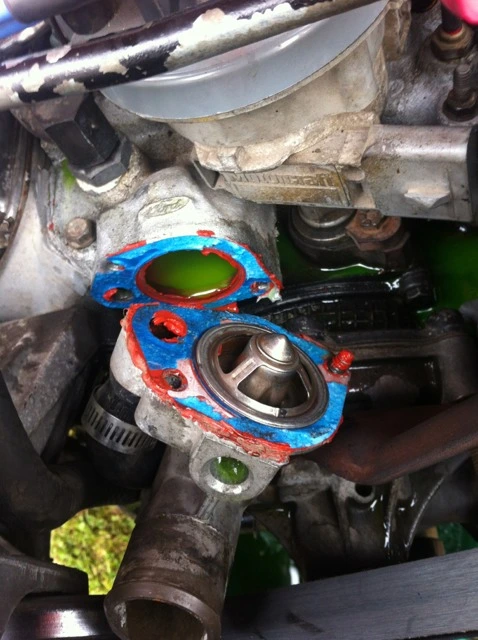

I guess whoever put the intake on had a brain fart ... we can close this one boys temp is mint
lmfao ... this is someone who puts mustangs together every day. for people go figure ... now there is almost zero permatex an best part is it holds temp now
