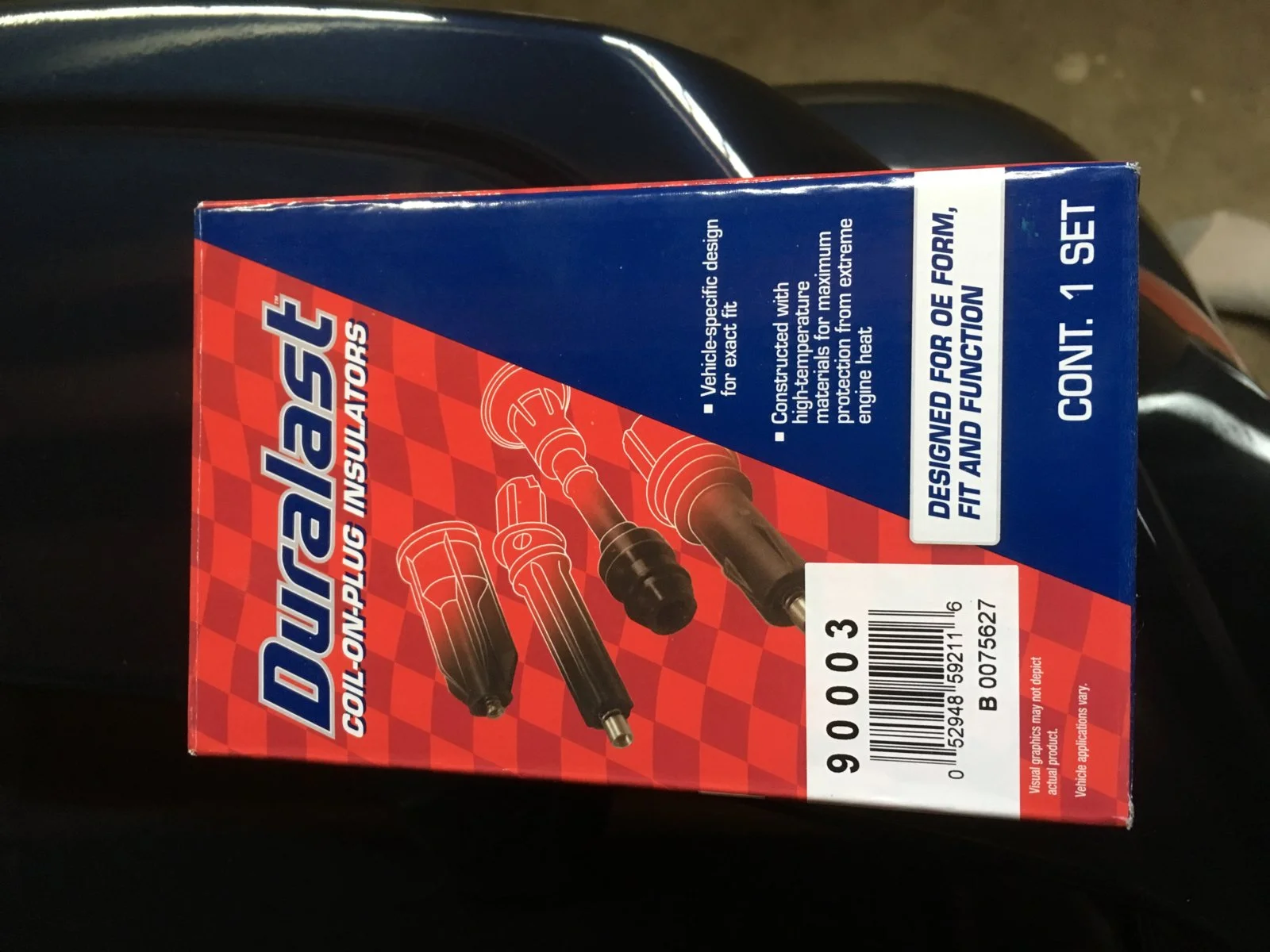

Neuron 5 Year Member Nov 6, 2016 859 192 93 Aug 6, 2018 #2 Aug 6, 2018 #2 No codes, runs good? I wouldn't worry, they seem do OK except when they get wet. When I do my spark plugs soon I am going to rebuild mine since it is so cheap and easy. Attachments IMG_2302.webp 123 KB · Views: 187
