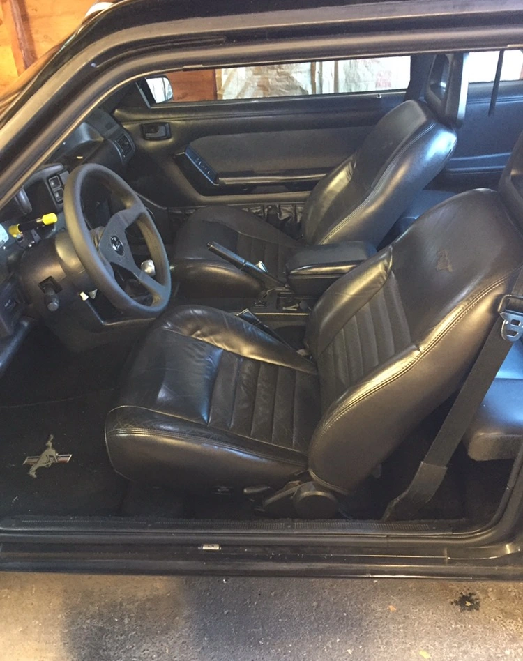

My #1 complain about the SN95 seats is they sit high. They offer no lateral support either. They look great in pictures, but when i drive my car i feel like i'm sitting on a soft fluffy cloud and it's quite a reach to 5th gear and to operate the radio. I'd like to be lower and feel wrapped up.

I had fox tracks first. I then swapped the 6-way power track on next. No major difference in height but I could tilt the front up and get some bend in my knees allowing me to slide the seat closer.
Height is only one issue. These have no lateral support. TMI has kits to convert them to a sport seat and add bolstering, but I wonder if that money would be better spent on aftermarket seats. Plus I could sell these as they are pretty mint

My main issue is height. I want to be lower. I was just sitting in my car playing with my current 04GT seats and unless I have them full recline, my head hits the Sunroof. So I need a partial gangsta lean back to fit. Makes 5th gear, the radio and HVAC an sawkward lean forward.
