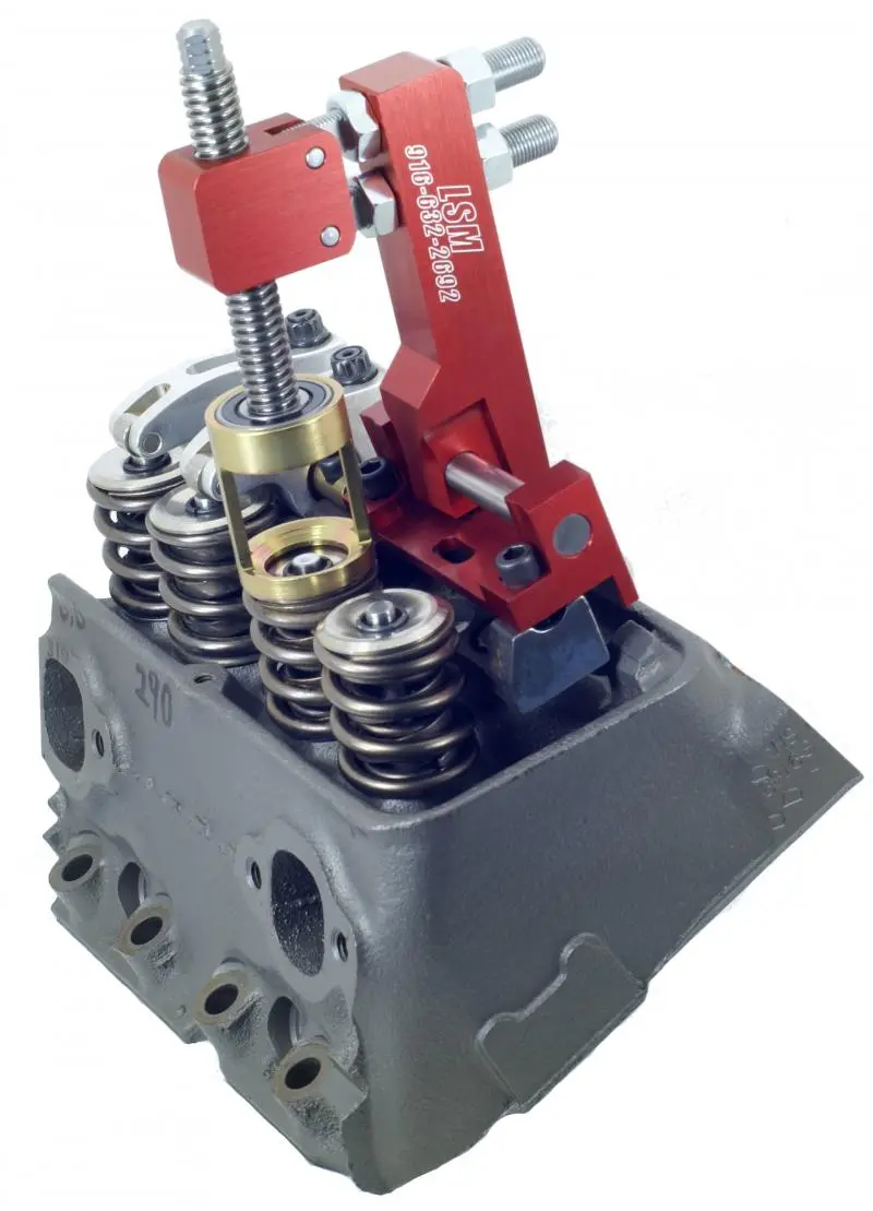

Ive used a spring compressor similar to this one
Quick google search brought up this company, might be worth a look

I have an old KD tools thread style compressor. It has two fingers that grip the lower end of the spring and a handwheel to turn. Works better than the other several I have tried, and not expensive. Bought a big c clamp style last year and returned it. the KD works heads on the car or heads on the bench.
